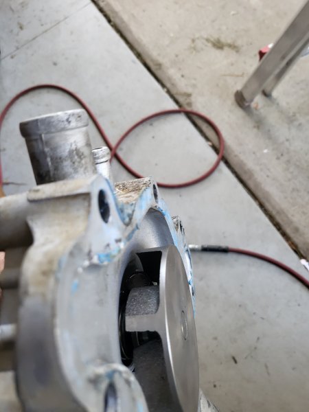

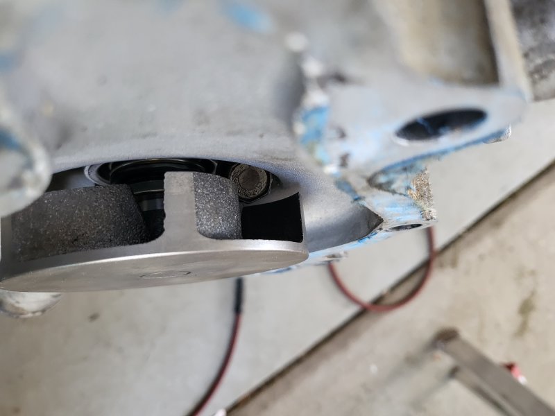

All done, Running great!!! It is still overheating at highway speed. RPM 2200+ it overheats. Idle all day no overheating. 1500 RPM no overheating. I don't know what else to do. I removed the water pump and it had a compressor bolt in it. I removed the bolt. It is an anti-cavitation water pump. I Reinstalled the water pump didn't affect the overheating. Gutted the thermostat to use just the body. Didnt help. Changed the head gasket. Didn't help. The radiator flows great. Hoses are good temperature. The bottom hose is 10 degrees different than the top. Even the hoses are not as hot as the engine. The engine says 220 hoses are 180. I'm starting to think it's a blockage in the engine somewhere. The flow goes up the hose and maybe it's not getting a good flow through the engine.
No wonder it overheats!! There is a BIG gap between the impeller blades & the housing. Ideally, there should be no gap. As it is now, water has an escape route; it just gets churned up, but not captured & pumped through the engine.
Go to the parts store and get a oem style pump.

Is that the stock magnum waterpump??
