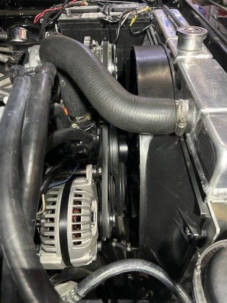

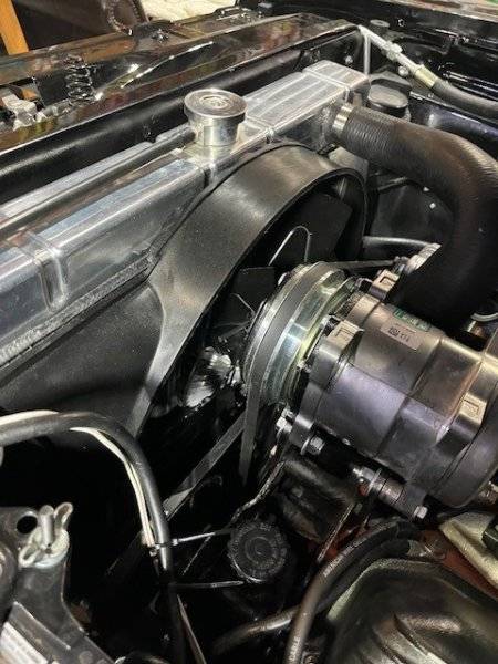

Maybe it's too late, but I'm not sure why you can't use a factory shroud. On one of my cars, I have a Wizard radiator which fits the OE shroud perfectly.
Because the factory shroud is different from one side to another. One side the second attachment point is in the middle. The radiator I have, has no middle attachment section (only top and bottom).
