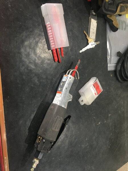

Electric body saw might work to cut hole bigger. They are fairly small.
I'd say it might indeed. I could always go after it with my Dremel, but those little cutoff wheels are brittle,
break easy and become lethal little missiles when they do!
Are the blades on those any tougher than for a jigsaw? There's another that likes to eat blades...
you'll be surprised how good they cut , ive been using them for 30 years , they aren't as brittle as jigsaw blades and I've used hack saw blades in it too when I needed to cut through a boxed unibody rails

these saws don't take much air my little compressor at home runs it fine and you don't get a face full of sparks and have to worry about your carpet catching on fire
