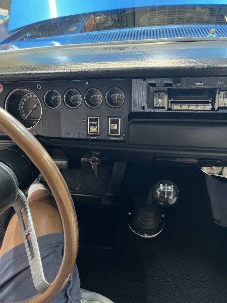

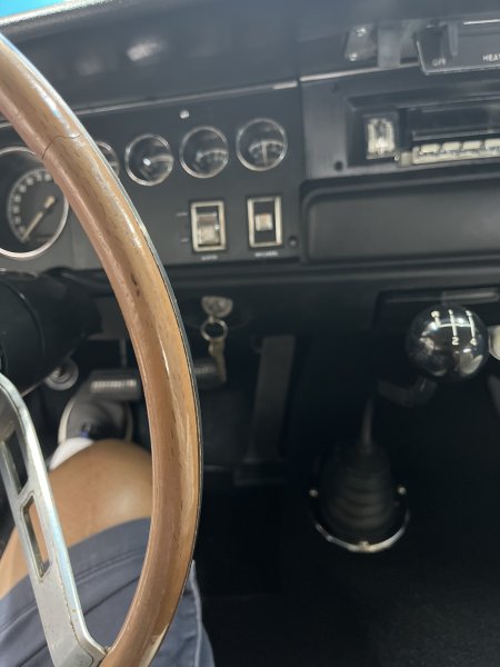

On a 1968 charger with 440 4 speed transmission, getting ready to actually drive this car. Got motor running, found first gear, found reverse gear, when I let the clutch out, it engages half inch off the floor, which is way too low for me. Also sitting in driver seat looking at the shifter, lever and knob, “seems” like everything points to the right more than it should be?
See pictures.

Maybe the wrong shifter handle for your year/model ?? Regardless of where it points, it won't affect the clutch engagement.

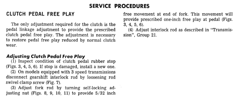

Your shifter is fine. To make the clutch engage higher up, increase the “free pedal” by adjusting the clutch adjustment nut on the clutch release leaver so that it pushes the clutch release lever further towards back of the car. Keep going! You’re almost there!

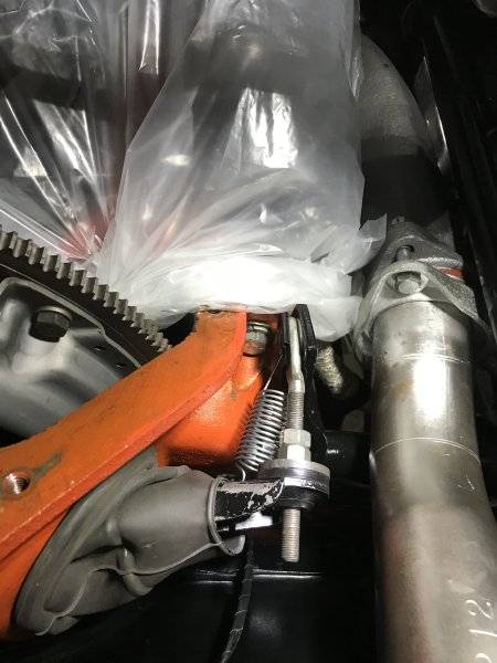

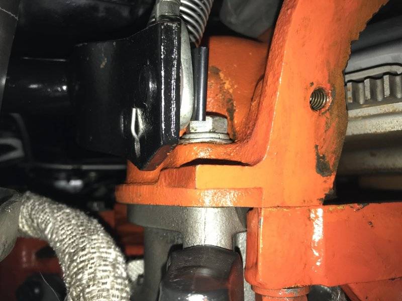

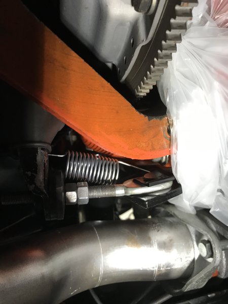

It’s down behind the starter. There will be a threaded rod and spring connecting between the clutch fork and and the z-bar. Some pictures. To move the clutch engagement off the floor you will need to turn the rod to lengthen it.
Loosen the locknut and looking forward, turn the big nut CCW to lengthen the rod adjustment. If you prefer a reference from the front looking back, yes, you would turn it CW in that case.
