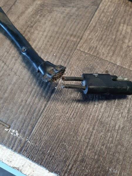

Ok so quick update.. thinking this may be a cause... drivers side wire hanging on by 2 threads and were in contact with other lead.. now wires have broken..
Your hunt appears to be bearing some fruit..
OK.. i have a quick update. I found that the connectors were very worn and crossed with exposed wires... See photo below. I cleaned them up and separated the wires... reconnected them and reinstalled everything. Ran a test and it appeared that they were working..
