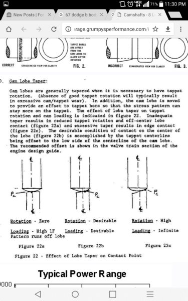

All cam lobes on NON roller engines have a taper to them. This taper does two things: It encourages the lifters to rotate and it tries to keep the cam from walking.
When you install the front timing sprocket it will position the cam properly (I'm thinking you should check that the sprocket has properly fit over the cam snout and isn't misalligned and pushing the cam too far into the block). The lobes are ground with a taper - the purpose of which is to rotate the lifter during operation. The taper is also ground on the front side of the lobe which makes the lifter put slight rearward pressure on the cam - thus negating the need for a cam button. The lifters also have their faces ground with an ever so slight curve.
So to answer your question the lifter should still be pretty close to centered on the lobe. And moving the cam with a prybar is proving nothing.

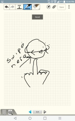

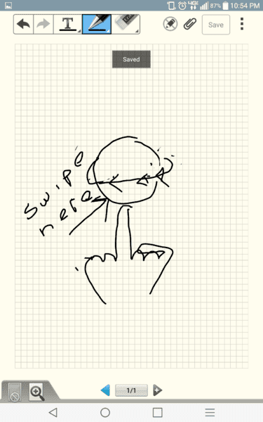

Think about it this way if the lifter sat perfectly centered on the lobe how would it rotate? It wouldn't, it would ride on the crown of the lobe, the slight offset & taper allows the lobe to spin it much like spinning a basketball on your finger. You don't spin the very bottom of the ball, you swipe the lower 1/3.
It doesn't lift the ball it basically gives it an axis to spin on...

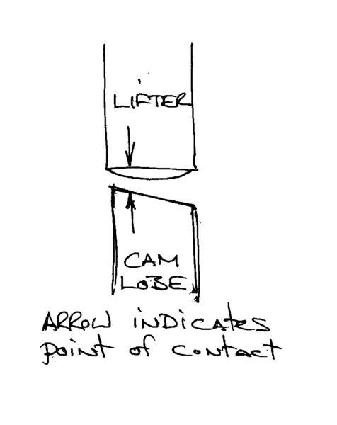

the taper puts the point of contact off center even if the lifter was centered but most I've seen have the lifter offset on the cam lobe
