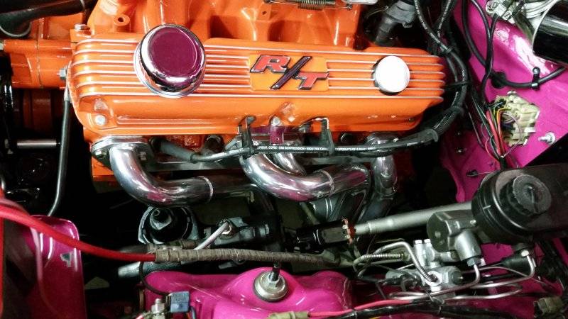

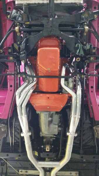

We even use urethene car paint on engines. Stand up to everything. I have engines painted over 20 years ago that look better than new. Obiviously use it on car bodies as well. tis engine painted in 2003. Car the same year.

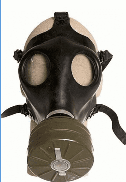

Any catalyzed paint is bad for you, isocyantes. Goes right through any respirator, that's why a fresh air suit is recommended.
Do you know, will they go through a gas mask like this?

a thin film of epoxy primer and ss urethane with stick to an engine for ever....... I'd use any of the main brands without worry
A full face mask is essential. While good air flow, shootsuit and standard respirator will get most of it, the overspray blow back will get in the eyes and absorb faster than filtered fumes the lungs. Most people can't make the commitment to a fresh air supply for 1 or 2 bits of painting.
