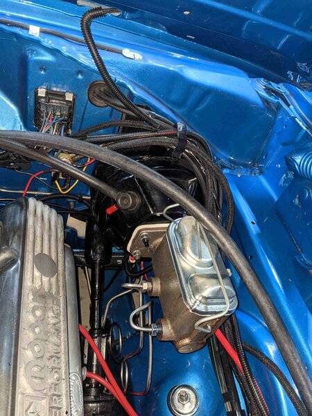

Is there a way to tell if my booster is dual or single diaphragm from the outside? There's no way to know from the history of the vehicle. It has discs in front and rear drums.

Thanks for that. How do you tell if it's single or double? The size of it?
The factory cars had dual diaphragm boosters on disc cars, single diaphragm on drum cars, usually. As others said, the shape of yours matches a Bendix dual diaphragm.
