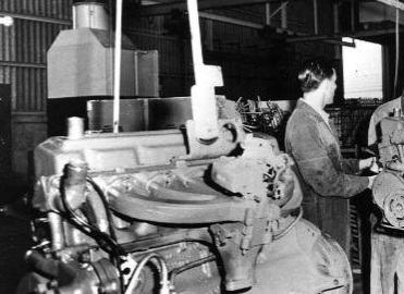

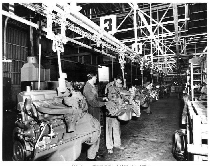

You'll see 2 holes in the top of the head next to the valve cover & manifolds those are your lift points. Good Luck
