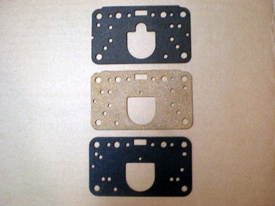

Are you sure you used the correct Holley gaskets for the carb rebuild? I see in one of your other posts a member posted a picture of a correct gasket to use as I know incorrect gaskets will wreak havoc on the Six Pack working correctly. When I rebuilt my Six Pack I think I found the correct Holley part numbers over on the A12Mopar forum. When I get home tonight I will post up the Holley part numbers from the gaskets I have.
Here are the gaskets,correct and wrong.Bottom is correct center metering block gasket,middle is 4 barrel,has small extension on top,looks like bottom gasket but different hole location,top is 4 barrel with transfer tube.Get either one in by mistake,it will run never as it should.

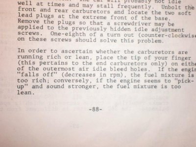

Set your initial timing at 15*,idle speed at 900 rpm,center carb screws out two turns,end carbs 1/4 turn and do what the second paragraph of the attached form tells you,adjust each screw one at a time until there is no change in idle speed then go back and re adjust center carb screws and idle speed.As for metering plates,69 1/2 use plate #6178 front,#6180 rear,70 uses #34 and #35 rear,340 uses #41 both front and rear.Wondering what main jets you are using and be "sure" you have no vacuum leaks and also the correct metering block and metering plate gaskets.
