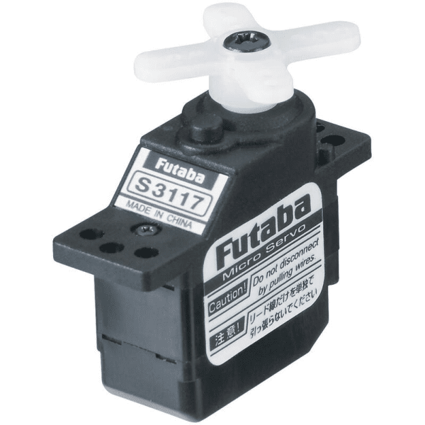

Another idea that I had was "maybe" using a RV car micro servo? (see pic below). Would there be a way to mount a servo on the six pack center carb (or intake) that could move the choke rod up/down like a RV car's steering might turn left/right? The choke rod is about the size of a coat hanger and it probably needs to move 1"-2" max & have reasonable strength to hold the choke closed vs the suction through the center carb. Ideally, I'd have a dial on the dash I could "dial in" how open/closed my choke is. I don't know anything about RV cars. Has anyone ever tried this? I think I saw a guy operating his air grabber hood with some type of electric servo (how I got the idea). What do you think?

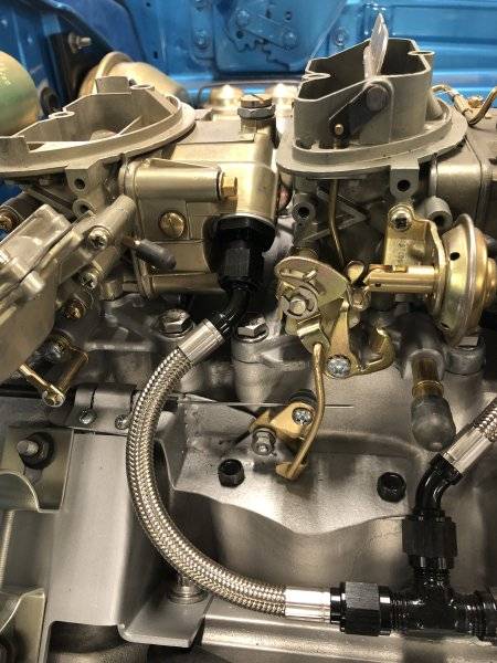

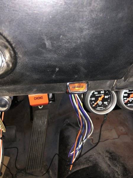

I had the same concerns. I made a mount with cable linkage to go where the choke stove would mount and used a manual cable I found on ebay. Works great!

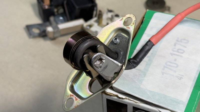

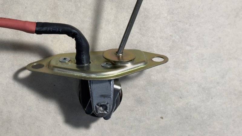

Frankenstein? Should I be offended? Pretty easy to do actually. The timers are easy to find now premade. I would disagree with those saying this original choke system works correctly without any manifold heat at all. The spring tension of the divorced choke vs engine temperature is specifically calibrated for having crossover heat present in the choke well.
