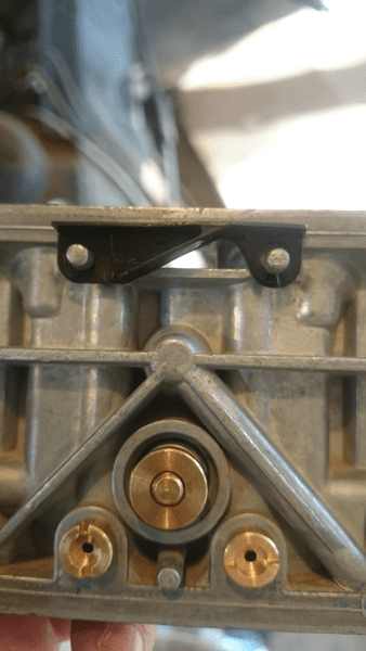

Are the fuel baffles in place? Top of the metering block..
Or the better design, known as a whistle...
And the hotrodders fix when both of the original Holley designs fail.... is a vent tube extension...
The one shown is the fancy pants version... Usually just a length of 5/16 hose to raise the vent higher prevents fuel sloshing out of the vents which causes the stumble/dying...
