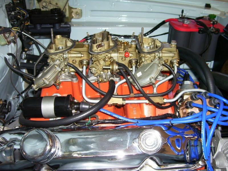

the holley 350cfm rating was taken at 3"hg, the bg 250cfm rating was taken at 1.5"hg. long story short, they're the same.
my current driver.
