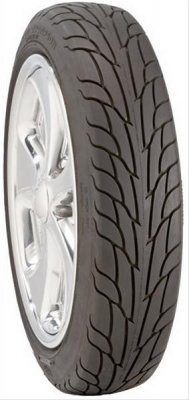

Anyone know if an 80 load range tire will be safe on a 70 RR? I'm looking at the MT Sportsman S/R 26 x 6.00-15 on a 4" rim and the tire has a single max load of 990. Have MT ET Street Drag Radials 295 x 55-15 for the back and want to go skinny in the front. Looking at this combo...

Probably not.....especially if your car has plenty of power and can daylight the front tires. If you have to lift for any reason, the load on them when the car rebounds will be a lot more than that. I used to run tires that were made for the older VW bugs on a 68 road runner with good success but I don't remember the load range. Probably less lol

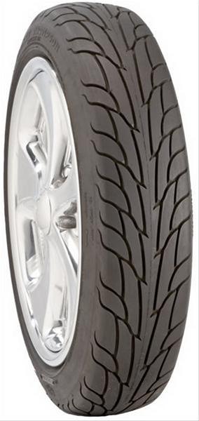

View attachment 198126View attachment 198125

You asked for opinions, so here goes. From what I see, the curb weight on a 70 Roadrunner is somewhere in the area of 3700 lbs.( probably get some differences of opinions here) and the weight bias is 54% front and 46% rear. A little math tells me that about 2,000 lbs. is on the front tires, or about 1,000 lbs. each, thus exceeding the load rating of the tires you're looking at. I'm sure there is some 'wiggle room' in their ratings but I don't know that I'd take a chance with a tire rated so close to it's max load.

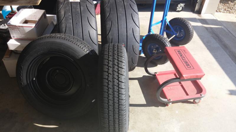

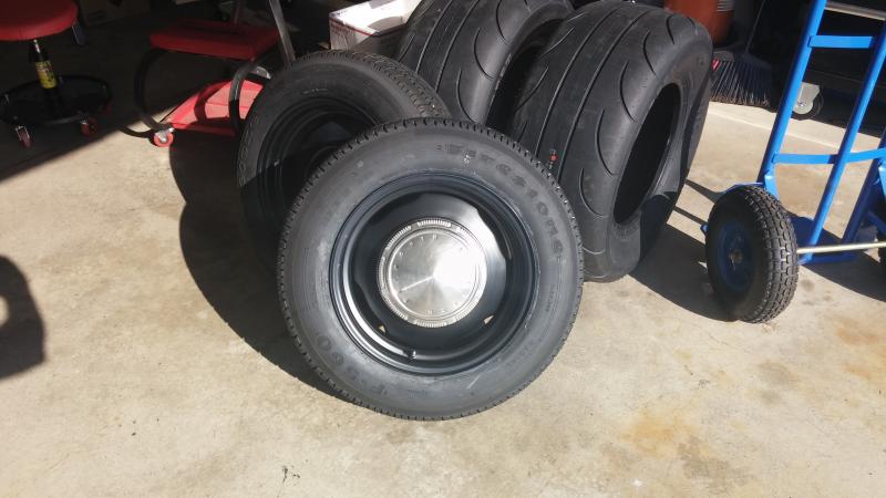

Thanks Cranky. I went with a Firestone tire 165x15 rated at 1170lbs on a 6'' OEM steel wheel (I have the same wheel for the back 10''). I like the black but I may paint wheels to match the car. My BFs are on orange wheel, so I may stay with the black for a change of pace.

I actually went with a 6'' rim but a 165x15 Firestone radial for the front. I get the skinny look but a bit more stability. 10.76 is a great time, are you using slicks or drag radials? It looks like slicks, 275x60?

I actually used a Firestone 165 x 15. I have not driven the car yet, still have not gotten the motor completed. I'll update once I'm on the road.
