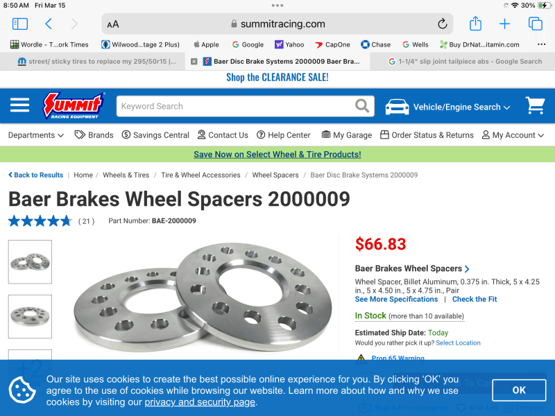

I was looking at these yesterday.
I could do those. I'd check the center hole register against the wheel register of your axles.
The ones I made were custom fit to the register on the axle, and drilled for the one bolt pattern.
(Those are drilled for chev, ford/Mopar, and some other who-knows pattern. 4 1/4x5?)

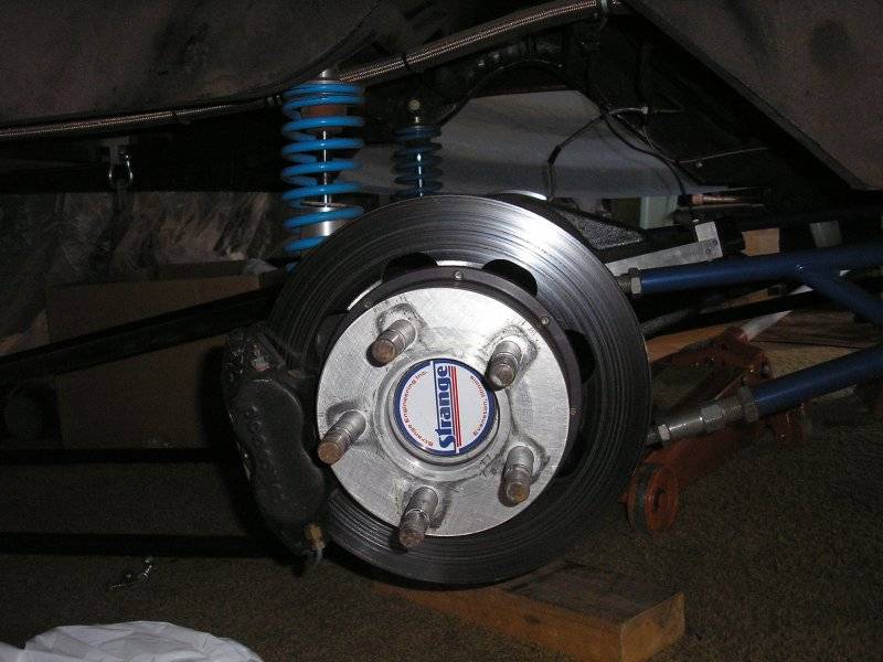

Uhhh, yeah. That is absolutely stupid. You went from a flat mounting surface of the drum or disc to four or five small pads about the diameter of a 50 cent piece.
He did this same bullshit years later with a crankshaft pulley (to make the belts align) and it flew off while driving down the freeway.

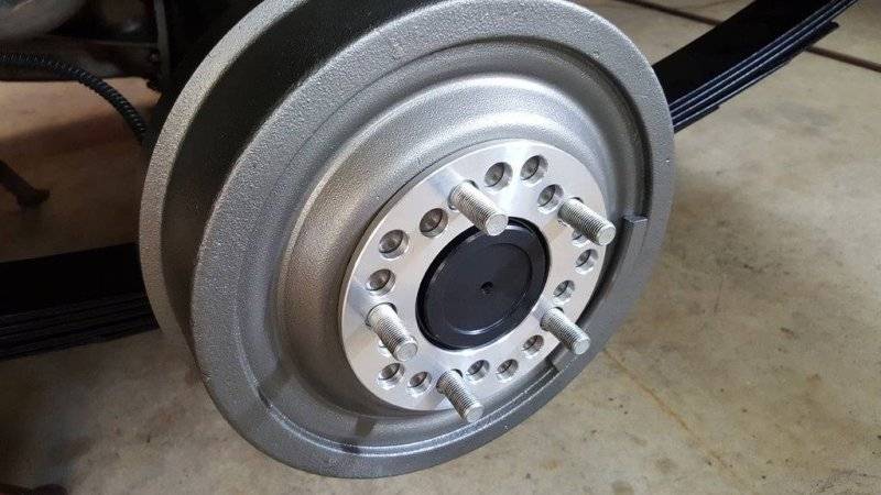

You don't have have to be afraid of spacers. You have to be afraid of poorly done spacers which is more often than not what I see. This is my setup. Heavy car with lots of hp. I lose zero sleep over this setup.

Well, I’m certainly not doing that. Earlier I showed a picture of a 3/8” spacer that goes over existing studs. I just wanted to know what the minimum clearance is? They’re heavy duty biased leafs with the burly sleeved rear hangers.
