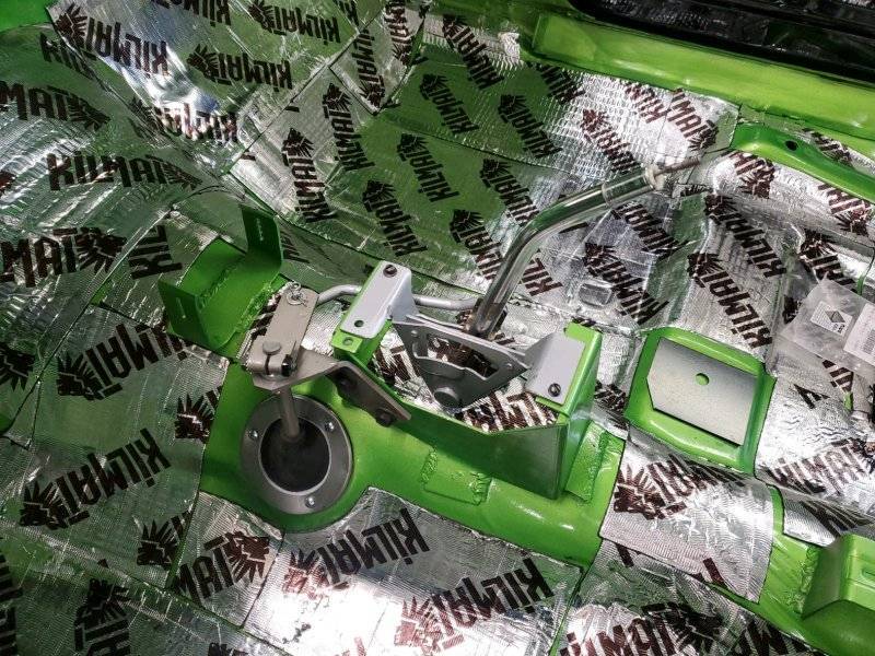

Mine has the stock linkage coming thru the floor. Then a short cable from the bell ctank going to a B&M shifter mounted in the stock console. Why would you not want to use the factory floor linkage? It's simple, bulletproof, and the cable wont melt.

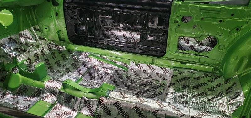

Original 71 Hemi Road Runner Column Shift.
You would have to weld all the console and shifter brackets in thefloor to attach everything anyway The boss for the bell crank is in the factory floor pan. Alonf with the screw locations. Just did this on a 70 Duster that was a bench seat column shift car.
Doug
Doug
Clean install, you do really nice work. I’m basically toying with the idea even though I would never do anything that wasn’t reversible to devalue the car. My column shifter is sloppy and I need to figure out how to rebuild it or get it rebuilt.
