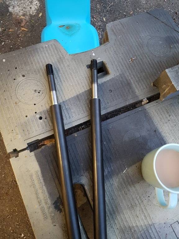

I'd search the internet for a local place that manufactures or supplies pipes, or an engineering company with lathes etc. My bushes came with sleeves (PST poly) but the Mancini Racing strut rods were too long with the new bushes. I'd read about people cutting down the bushes but instead I got a local guy to turn down 32mm off each rod for $20 each. It's amazing what trades and skills are out in the industrial areas behind anonymous roller doors.
