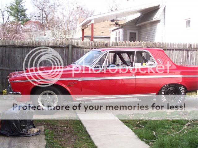

I run these 30 x 9 Hoosier radial slicks in my stock wheelwells with my springs in the stock location. I use 4.30's with a Dynamic 9.5 converter. My eng is a mild 493 making about 600 flywheel hp and I race through the full exh on pump gas just as I drive it. To be honest I feel it might be faster with less gear as I would love to go to 4.10's or 3.91's as I feel it would mph more and pull the lower gears fine. But you can fit 30" tall tires in my stock wheelwells. With your 4.10's I would run somewhere between a 28" to 30" tall tire depending on the eng and converter. Ron
