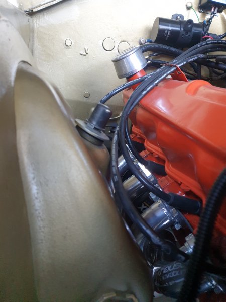

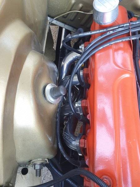

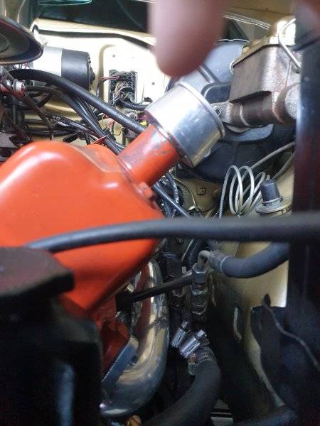

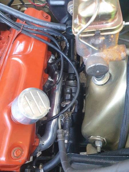

take a look at the header tube too close to your power stealing hose going too cook the PS fluid.
My 2-cents? You just put on headers. Your plug wires "look" like they're too close to the headers on the driver's side. Headers burn up plug wires quickly. Also, for new wires, often the plug end pops off the spark plug (happened to me many times with new wires). So.....I'd suggest you take a hard look at your plug wires and maybe get longer ones and/or add heat shielding (if burnt) before you start changing jets. Just my 2-cents
The headers are ceramic coated (polished) which should help with the temperatures/burning leads, but I'll have a look at it this morning and maybe wrap them in foil until I can get some proper heat shields.
The power steering fluid didn't boil on the 60 mile trip home but I'll look at insulating that too.
The plug wires are actually at least an inch away from the headers which is good news, the photos are deceiving. I will do something about the PS hose though, even rotating the hose clamp will help to bring the nut away.
