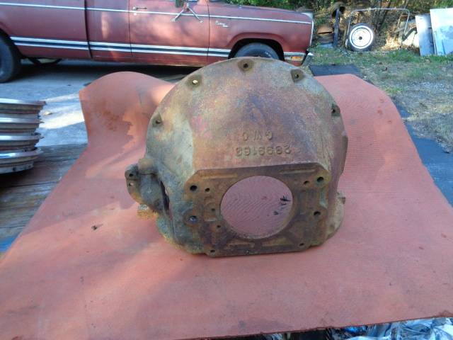

I have a cast iron one from a truck that I just put on craiglist. I took it out of a 67 Barracuda, but the numbers say it is from a truck. I think the cars originally had aluminum bell housings.
(On the Roanoke, Va. Craiglist if you are interested)

That Cast iron one was widely available in trucks
what's the diameter of the hole?
