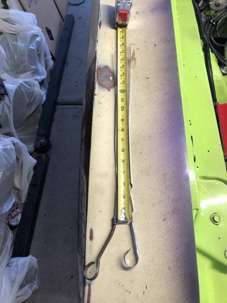

What I do know is this is a 1973 340 block that is using my old stock 318 pan and pick up.

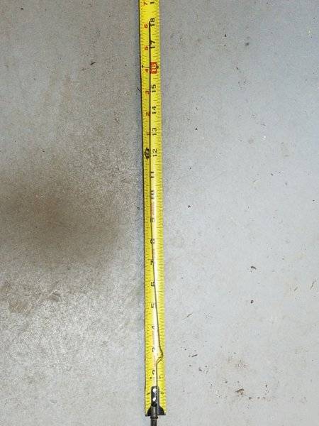

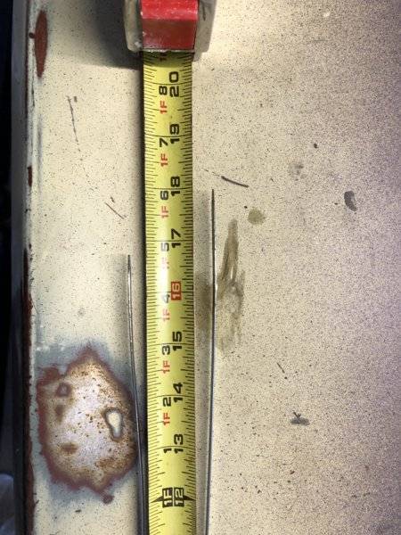

I compared the DS from my current engine (after market) and the one off my 318 (which I believe I should be using now that I found it). I found that the Original 318 DS is 17” while the aftermarket is 18”.
QUESTION: What length is YOUR DS in your stock small block LA?

Original dipstick from my 67 318 measures 18" from where it stops on the tube to the tip.
Thanks copper67sat for taking the time to help me. Thats how I measured it as well. This is very interesting as my older don’t know if original DS was 17 while aftermarket is 18 as yours is.
I think another data point would be great.
