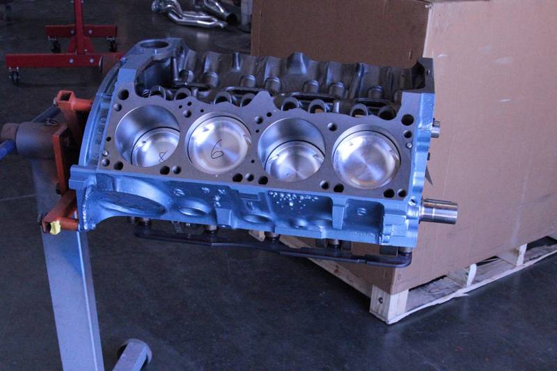

It's been an interesting build, but it's getting close to completed. A few more touches and it's coming home.

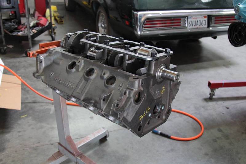

I started with a 1973 360 block, and Scat Crankshafts put together a forged stroker kit with JE Pistons. I added a Main Stud Girdle for bottom-end strength.

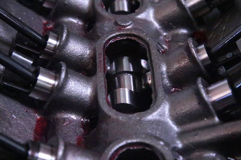

Comp Cams put together a Camshaft, Lifters, and Roller Rockers for the Edelbrock Magnum heads. I used an Edelbrock Super Victor Intake for Port Injection (FAST XFI) and Edelbrock drilled the heads for an LA Intake for me.

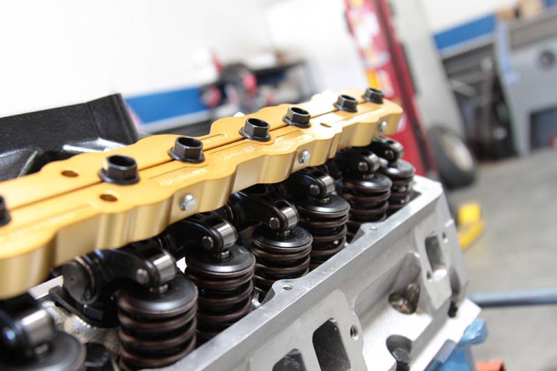

Up top, we added a set of Jomar Rocker Arm Stud Girdles for top end strength, and currently - because of the upper stud girdles - I'm having a set of valve covers made by Williams Manufacturing in Lake Elsinore.

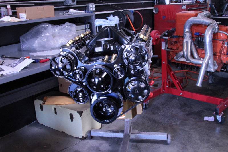

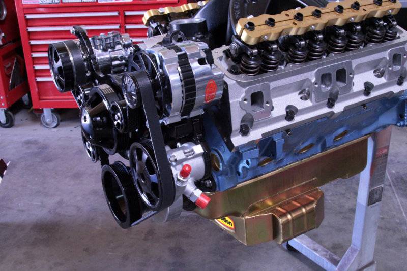

The front drive will be a Billet Specialties setup, and I'll run TTI Exhaust headers. The whole package is buttoned up with nothing else but ARP fasteners.
LOL I had the block painted close to the color of the car.... I'm really liking it. Can't wait to get the front drive installed.
Yes, 408 cubes using the 4-inch stroker crank.

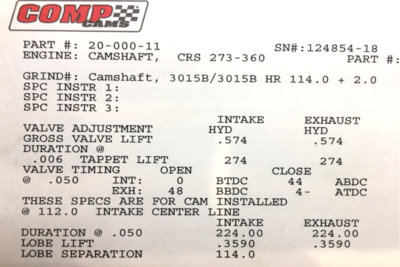

I'll try to get the cam specs for you soon... the heads use a 1.6 SBC stud mount rocker, and we're running [lower] compression for the second part of the build. hint hint

If the Comp Cam isn’t a .904 specific lobe, your using the wrong cam. Etc....

The kit that I found, oddly enough, wasn't even known to Edelbrock - yet it was designed to fit the Edelbrock Magnum heads (3/8 stud mount, 1.6 SBC rockers).

Jomar.com will get me where I want to be for the
rockers?

On the rockers: those are Comp Cams parts, Jomar Performance makes the rocker arm stud girdle for the Edelbrock Magnum heads. They private label some products and make a few others, lots of experience and interesting guys there. The stories they tell, and the knowledge they shared... enjoyed chatting with John over there.

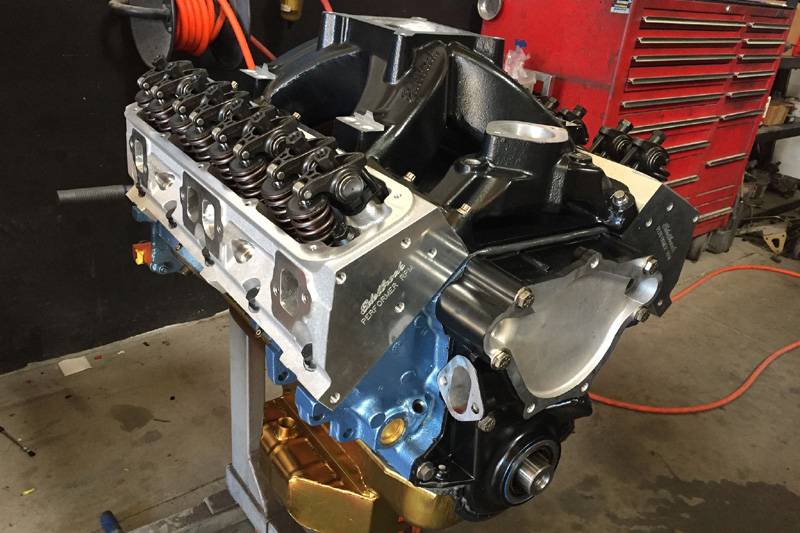

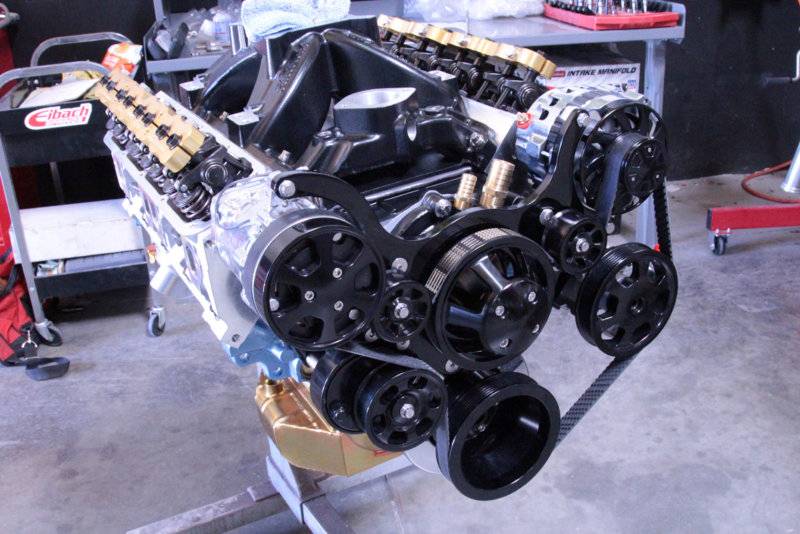

A couple more pics of the LA build, I'm still waiting on some custom spacers and valve covers to clear the rocker arm stud girdles. I installed the Billet Specialities front drive this week, and it's a really nice kit. I needed a front drive that would stay within the profile of the engine for clearance purposes and how we're routing the exhaust. (hint, hint)

It depends- the circle dish can work with a real tight quench distance and if the compression is way upup - good gas and at higher rpm
A step dish or a D Dish works better with lower compression builds, or bad gas as you get a squish effect and more turbulence, you also have the two cool surfaces and the narrow gap together to prevent detonation
which on a mopar usually starts away from the spark plug side (unless there are spark plug threads glowing or that kind of problem which should always be addressed
now on a race engine you can have the quench area too big- where that circle dish works- and where they claim that it does not make any difference as it will make the same horsepower. IT CAN
but not under a lower rpm load
anyway to much quench in a race engine can have so much squish together flow blast that it interferes with the combustion/ ignition
then you make the dish larger and shallower until you end up with what you have I usually ended up with about 3/4 inch quench D Dish
I think I have a couple of pistons I can send photos of if I can get to it and if anyone is interested
as I said you can make those pistons ok if you keep your quench real tight- and they are easier to make- but IDK nowdays with CNC
cheers

Hey! I never did get your camp specs. Lift & @.050. Also, are the heads ported or box stock?
