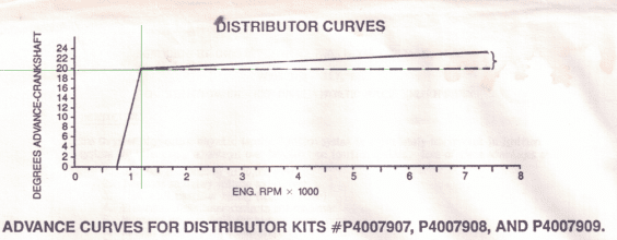

That is a MP distributor. 50 is the week and 6 is the year. The springs you took out sound like the oem ones from Mopar. They sell springs two really light ones I don't like them they slam into full advance like in this chart. (just about the same) Figure out what you need I have a ton of springs if needed.

Yes six is 76 by that number. Make sure it has a decent curve don't think you want it full from the start. Vac really depends on how radical the cam is also.
