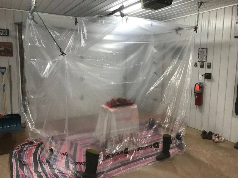

Was just wondering if anybody used one of those small painting domed shelters to keep the overspray down? I see some of them can accept a fan for exhaust. Up here in Canada our HF=Princess Auto has them on sale for 20 bucks for the small ones. I geared up temporary paint shelters before. PITA Just wondering if it might be worth it or stick to the giant cardboard boxes??
Wagner Spray Tents & Shelters for Paint & Stain Spraying versus...
I've never used a store-bought before. Just plastic drop cloth taped to rafters and a shop vac nozzle inside to pull down paint mist.
They had the larger one's on sale a few weeks back. These things are probably fine for painting with spray bombs but if you're shooting with 35 PSI out of a gun the "tent" probably isn't going to be much good.

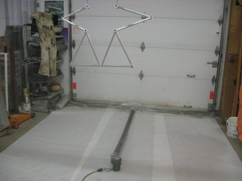

I've done this more than a 100 times... squirrel cage blower and a length of ABS...(of course before I had cars in the shop!). A few sheets of hung plastic and it would be a mint booth! LOL

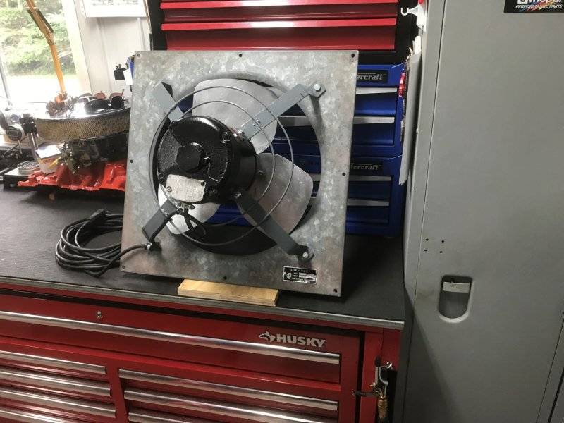

Roger my paint man gave me his old paint room exhaust fan. Gave me right! lol She's a monster! One of those sealed explosion proof fans.She would suck the chrome off of a trailer hitch. Suck in any plastic temp paint booth. Here is a pic of it when I got it and cleaned it up.

Whatever exhaust fan you use - even a shopvac, you need makeup air for efficiency - crack a window or a door. That can be a bugger in colder weather but it only has to be open while the fan is running.
