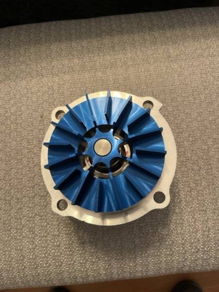

You may also consider a higher flow water pump. I installed a Flowkooler.
It wasn't the magic bullet, but it did contribute a lot to the solution.

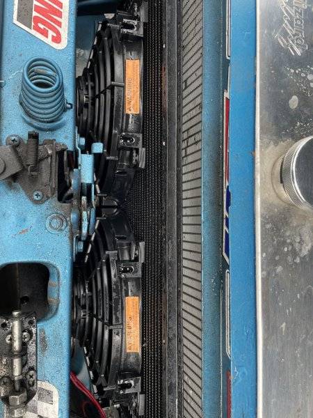

We fought some of this on the ‘68 Coronet. I agree that the 210* is not overheating but these big blocks on today’s gas get really unhappy trying to idle with that heat creep. In Atlanta so stop and go traffic is not avoidable or you would never get to drive. I chased it all and the correct fix for me was getting the right electric pusher fans to take over while the big cam loping around at idle has the clutch fan essentially doing nothing. I ended up with (2) Spal 10” pushers at I think 1450 cfm each. It moves some air now and fixed the heat creep and as an added bonus I think it pulled the ac temperature down a few degrees as the fans are mounted on the condenser.

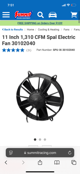

A few notes. Not all electric fans are created equal. Some rate the cfm unloaded with no static pressure and some (Spal) have available pressure charts for each fan to see the actual cfm production with static resistance which is what happens in the real world with a radiator and condenser in the way. The usable cfm drops off incredibly fast with resistance. So, to save everyone some time, get a Spal in the size you need.
Controllers. My experience with Derale is poor to poor. I went thru 3 over a year or so with each failing in different fashion. These were the units that mount underhood which I always suspected was not the best design or mounting option. Luckily, on the car build we installed the Dakota Digital dash and they now make a compatible fan controller that integrates into the dash computer. It mounts inside and has been flawless and the best part is that it is Bluetooth and tuneable. I have it set to run 100% ac on and then on at 195* and off at 185*. Even better since I run a carb, if the fan is running at shutdown, I have it set for a 3 minute shutdown delay which helps kick that heat soak out during the heat of summer when running errands and you will be back in a few minutes restarting. Today’s gas does not like being unpressurized in summer heat. Fuel injection does not see this due to the pressurized system.
Old fans before upgrade. These were Summit branded and just did not push any air.
Spal model used.
