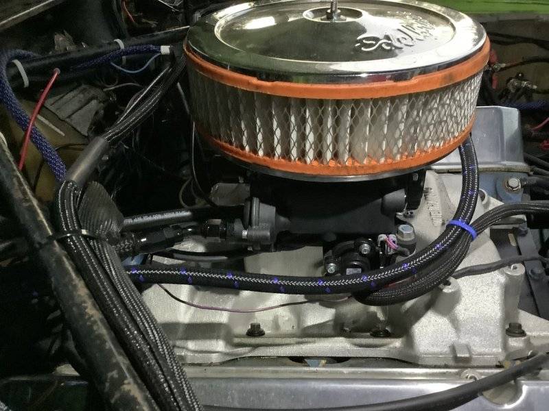

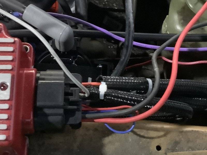

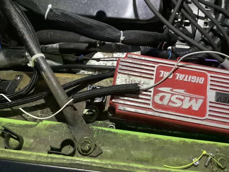

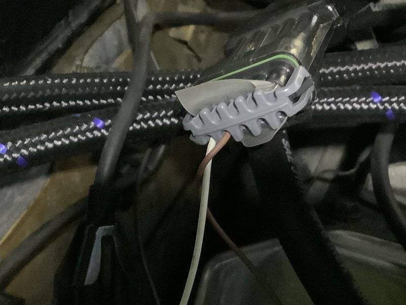

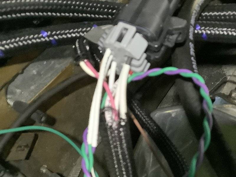

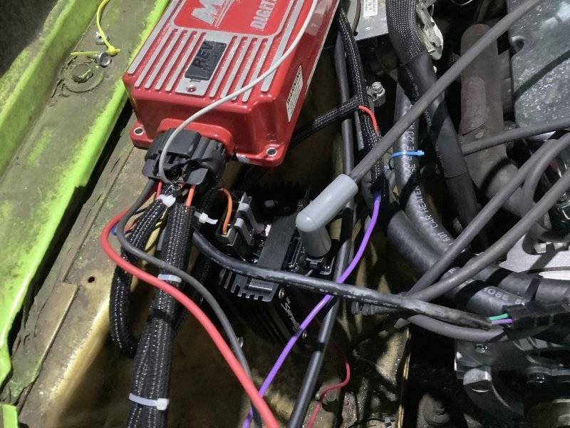

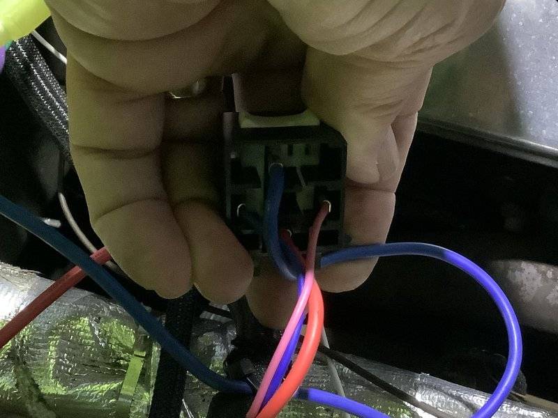

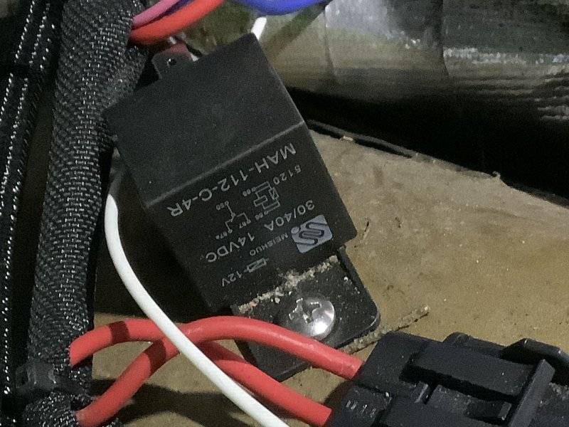

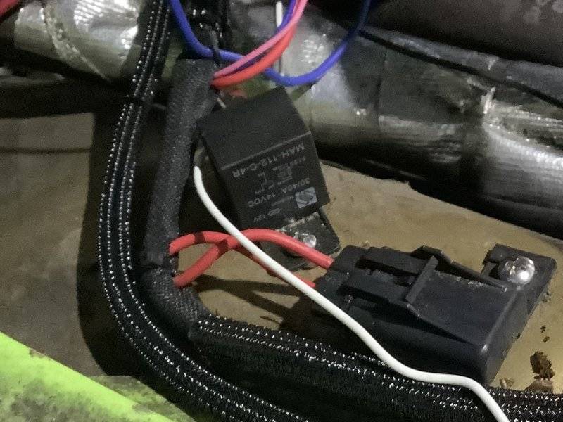

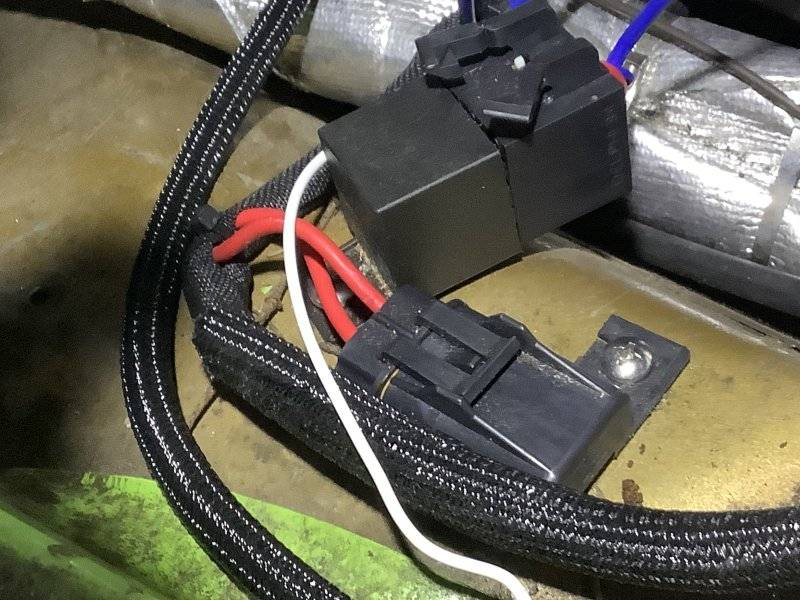

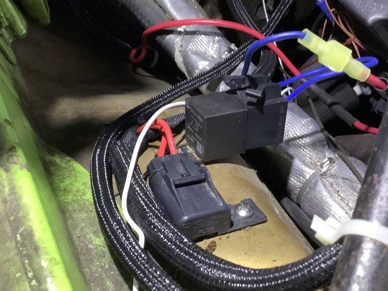

Ok, I'm not following. Can you post pics of what you have? The sniper does not put positive voltage thru the fuel pump wire, it puts it to ground. Had a guy return a unit insisting the driver was bad, got the new one, which was a huge hassle for me, and it did the same thing, then they hooked it up correctly. Just trying to help you and work thru this. I'll bring up the Holley wiring diagram so I can see what you are referring to. Been a few months since I wired in a sniper unit.
Edit: After looking at wiring diagram, the blue wire is a positive output, however the sniper grounds that relay in the processor to activate it.
I really appreciate your help with this. The sniper efi came with the relay and fuse in the harness. Mine has blue wires running through the relay and power from the fuse. one side of the blue wire is grounded by the sniper to power the pump. I can see how people may get confused because the wire colors should have more colors but that’s probably a cost difference.

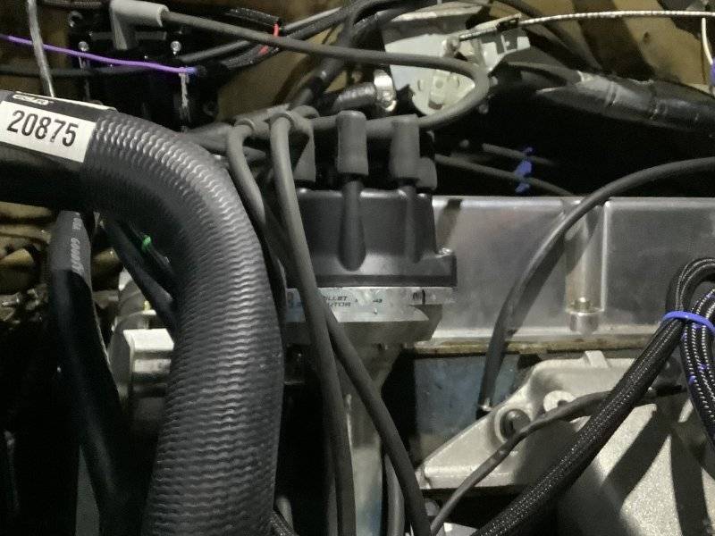

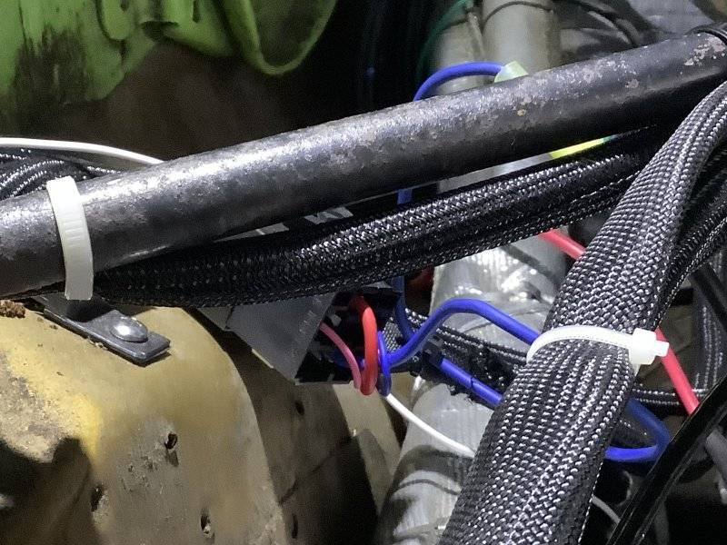

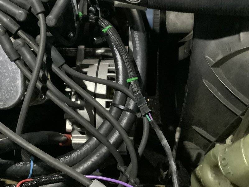

I don’t have any current pictures because I was not thinking about being here asking for help. I am going to have to go over the wiring again but I don’t know what I am looking for.
I hope this helps you draw a picture of what I am working with.
Here’s some fresh pictures from tonight. Hope these help .
I'll look at a wiring diagram tomorrow and report back.
Sounds like the fuel pump is timing out.....and that coincides with the start up procedure.
That’s kind of what I am thinking but it’s showing rpm’s on the screen when trying to start, and makes me scratch my head.
