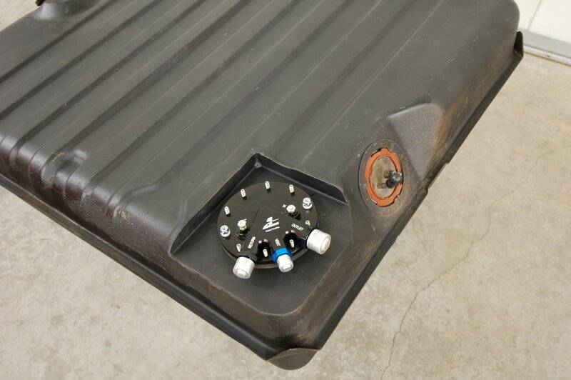

On my '65 Coronet I had to have the tank modified for the pump. Nobody was selling a drop in unit back in those days.

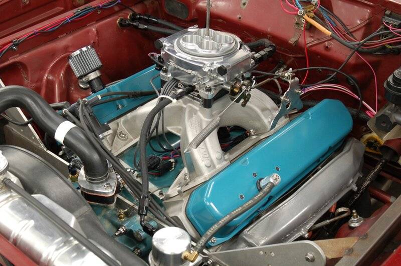

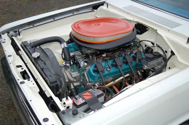

Looks good. I've been running a Sniper/Hyperspark setup on my Coronet for a while now. I used a Holley port injection setup on my Duster though.
View attachment 947202 View attachment 947204
