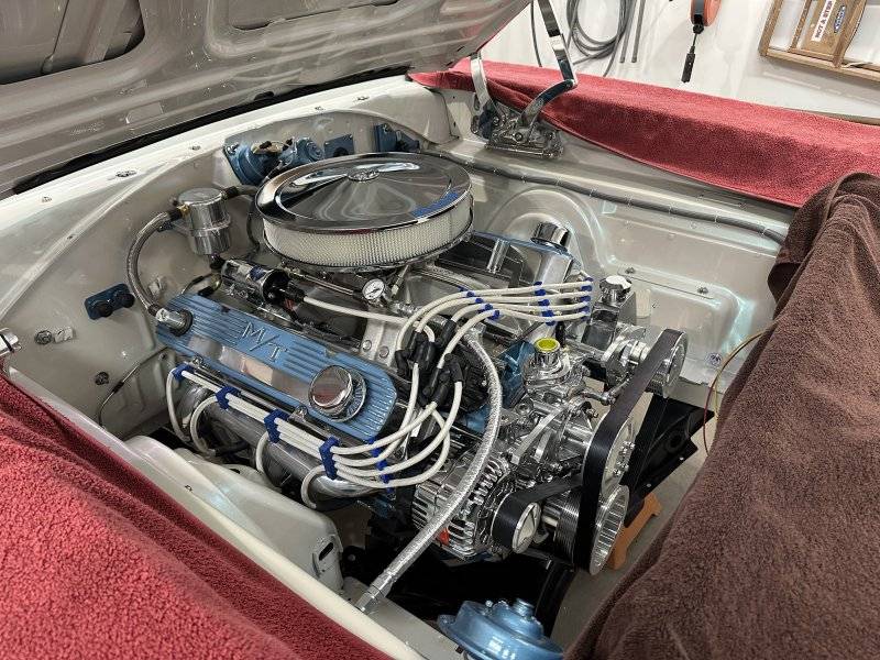

That's a nice looking engine bay RunnerThe coolest thing about the Pertronix units is that they look relatively stock.
