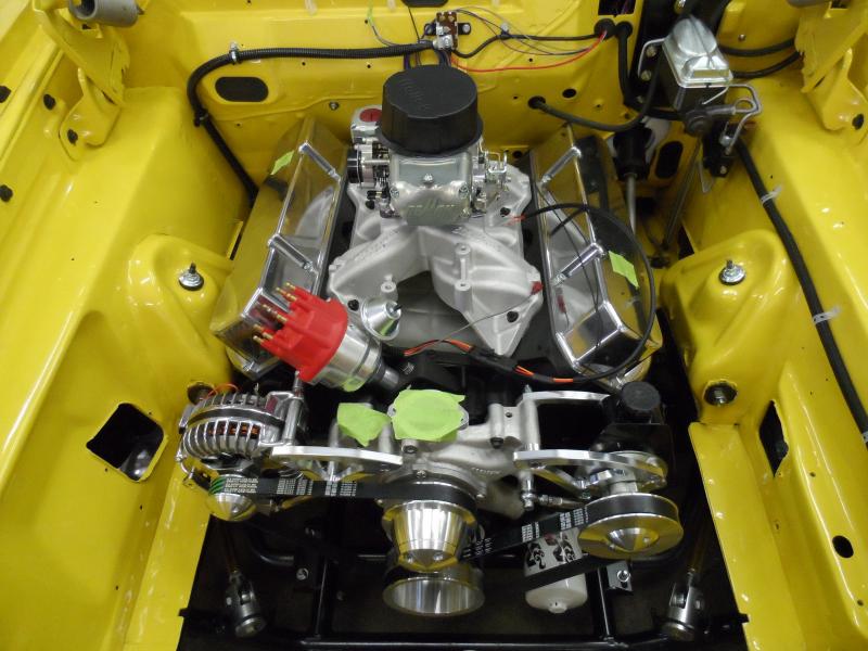

SAM_0508.jpgSAM_0546.jpg400 with 4.15 because we just finished one in my 65. Vroom Vroom
