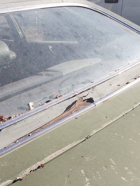

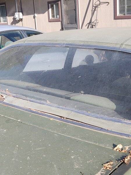

My '71 Plymouth Satellite is 50 and has weathered the decades well. She is just starting to crack and peel. How do I repair and protect?
Properly;
1. Remove old vinyl top.
2. Install new vinyl top.
Or; if you're looking for a less costly repair
Get a caulking gun with some silicone and goop er up.
Remove vinyl top and find ma mopar didn't prime or paint roof. If your lucky there won't be rust holes.
I hope its all good underneath ,rip it off and replace it.
Don't let all those leaves fill up under window trim and decklid water troughs.. It will rot real quick if they are there and stay damp..
It’s histoire!! Needs to be removed and replaced. Maybe some metal repair, but hopefully not.
