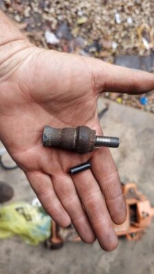

I GOT IT¡!!!!¡
Pressure hose has gotten blocked up.
WTF
I blew through it in the beginning and could swear that the air went through.
Seems to be blocked at the coupler in the middle as I can push a wire from both ends to about that point.
New hose will be here next Wednesday.
I knew it I'm a dumbass.
For any one else reading this double check pressure line to be clear of obstructions if you are experiencing these issues.
Wham bam out of the blue plugged
Self induced dumb assery.
I must have stuck this vacuum plug in the pump outlet when I pulled the motor.
Many months later I connected the hose right over the top of it.
The pressure lodged it firmly into the middle coupler.
My original conclusion was correct, pump was dead heading.
Hose was clear when I blew it out then I preceded to plug it upon installation.
Hope everyone that reads this can get a chuckle as I'm currently laughing too.
This also answers the age old question of whether that thing in the middle is a pressure reducer. Nope just a coupler for the two hose sizes.
