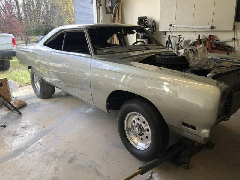

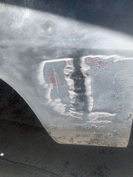

Helping a friend who wants to paint his car himself... I'm just providing guidance.. We've started stripping paint, gonna take everything down to bare metal... I'd noticed there was some filler on both front fenders... I hadn't put together why... Now I have... They brazed up some emblem holes.... Then bashed the area down & mudded her up... A little hammer & dolly work would have gotten it down to less than a teaspoon of filler... Instead the whole area was over 1/4" thick.... Honestly if they had just blocked the mud till a few high spots peeked through it would have only been 1/8" instead the whole area had an unnatural crowned shape.... Both fenders were this way... When it's done there'll be less than 1/8" of filler...

It was securely bonded to the steel... But it wasn't even close to an invisible repair.... The first time I saw the car I knew there was filler on both front fenders... I just didn't know why.... Pretty simple really if you consider beating a dent into a previously straight panel then filling it with bondo an acceptable repair I wouldn't want you working on my stuff...

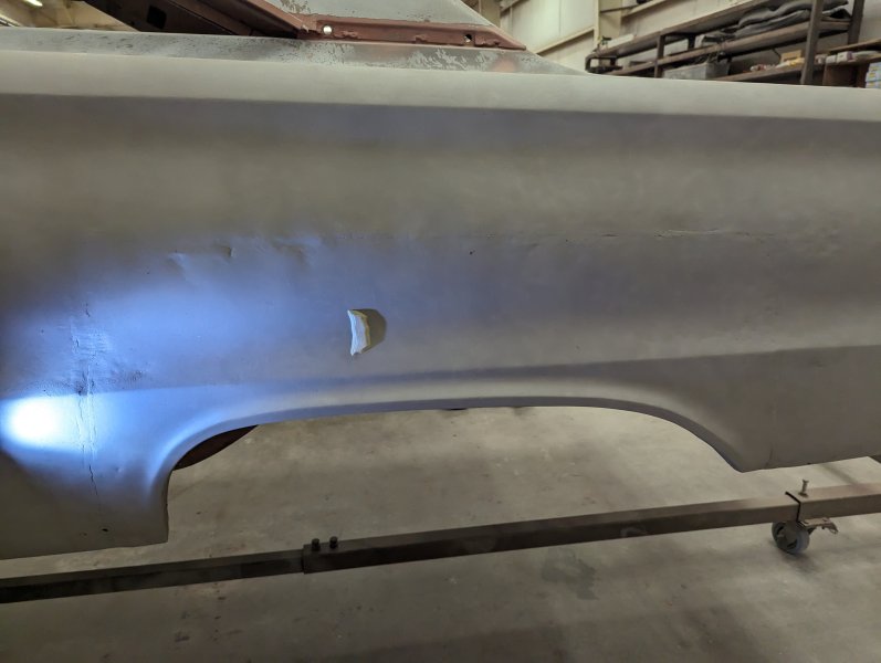

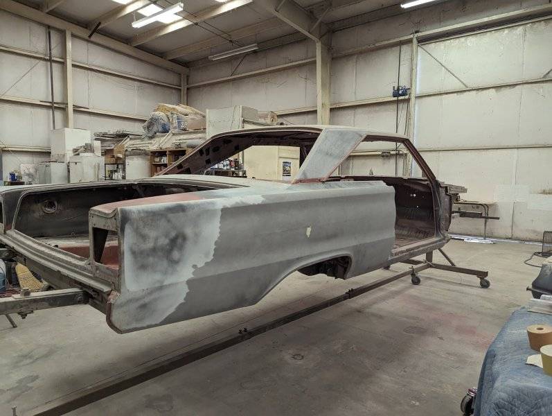

Just went through the same thing on my 67. We uncovered a lot of bondo and decided to replace both quarters.
They were supposed to be good to paint but something didn't look right to which we uncovered lots of bondo and warping on both sides.
Glad we caught it so it will be right.

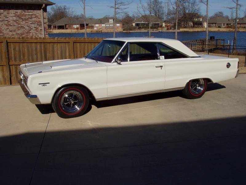

My 67 GTX has more bondo in it than I appreciate. One lower quarter has been replaced and looks like a fairly nice, butt-welded repair. The other side has some crap in it right behind the wheel well that I can feel down in the trunk drop off. The guy I bought it from said it had damage there from something but not rust. I would say that’s questionable. But after 20+ years nothing is surfacing. But the guy who painted it skipped filing several minor dings and apparently had no concept of block or board sanding. It’s saving grace is WW1 white paint. I would like to fix everything and repaint it but I believe in doing that sort of thing myself and I don’t have access to a paint booth and restoration paint shop prices have gotten ridiculous. Talk about inflation. So . . . Makes a good cruise night car as I don’t worry about kids, drunks and idiots doing it any damage.
