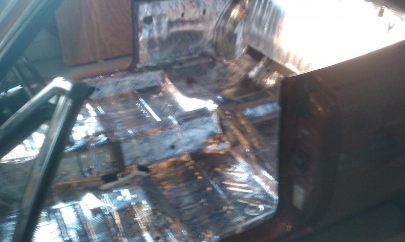

Did the floors, roof, front of the wheelhouses, inside of the doors, inside the rear interior panels......Used about 75 SQ FT
I just did my GTX, I used Fat mat's rattle trap product 100 sq ft and did from firewall to package tray and doors with about 20-25 sq ft left over.

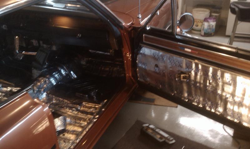

you are the first one i've seen do the inner door panel area instead of putting it on the inside of the outer door skin ... i'm interested in the effects on putting the door panels on/fit finish etc. anyone else done this?
All four panels fit perfectly although I think inside the door would probably be a better job overall.

OH and by inside the do you mean on the inside of the outer metal door skins? I thought about that, makes fixing problems in the door easier, but I was concerned about repairs to the metal at a later date in the case of a accident.

Yea, most people it seems do the door skin itself from the inside and I think that it's probably the most effective in terms of the product doing what it is supposed to do.
But for me getting behind the window mechanisms through the small spaces in the doors and rear quarters and doing a good job at it seemed near impossible, also you can always cut an opening if you have to and then repair. That was my reasoning, I may not be right.
