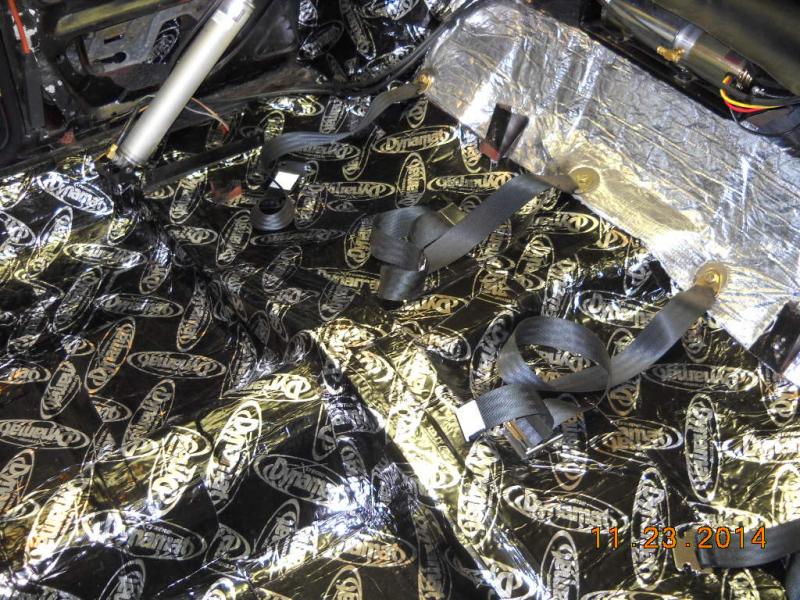

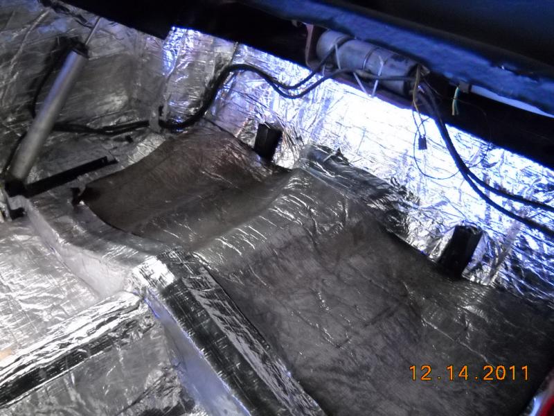

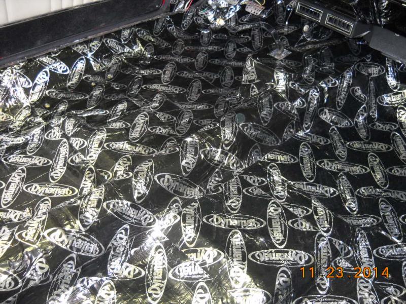

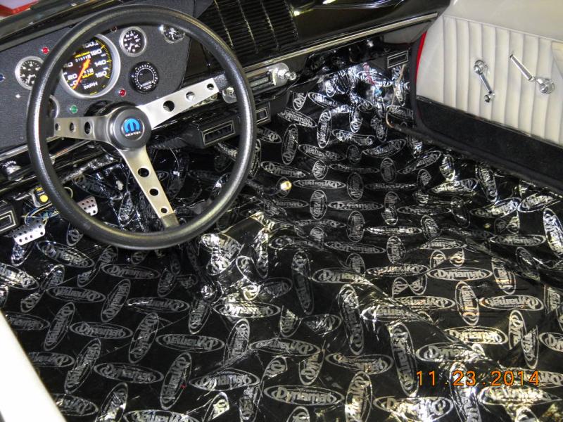

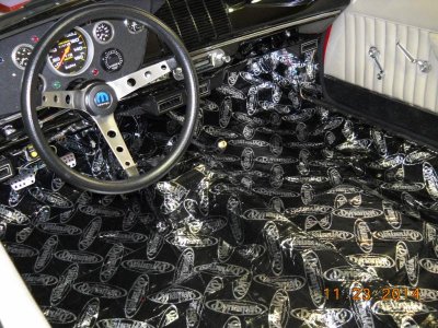

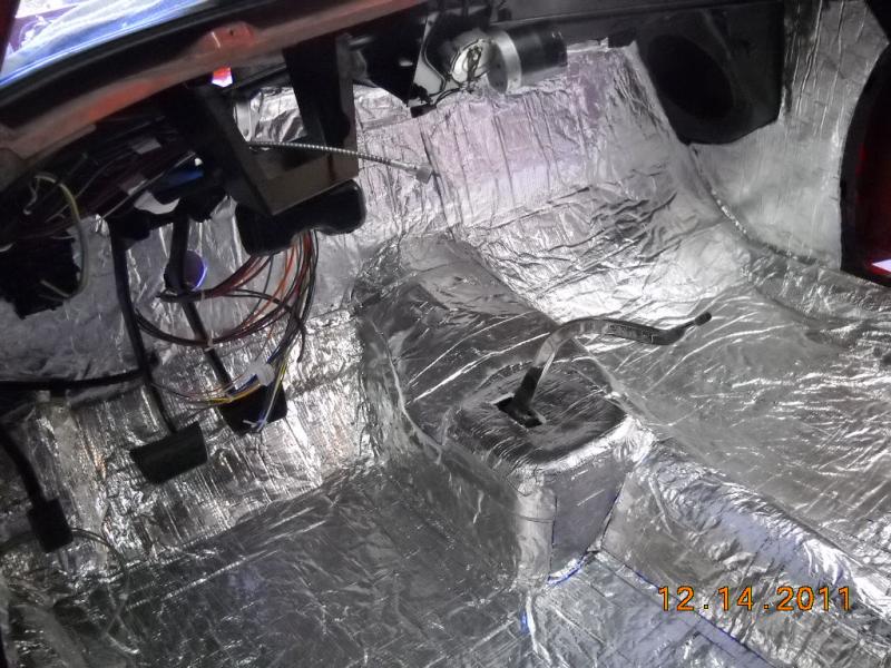

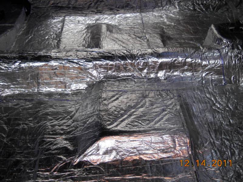

First time around I used the insulation with aluminum on both sides of a layer of fiberglass. Wasn't too pleased with the sound deadening so I took it all out and went with Dynamat. Very easy to install and sticks like crazy. If you bang on a panel without it and then again after it's installed, the difference is night and day. Same thing with the door skins and quarters. I'm very happy with it. If you buy it in the box of 20 12" X 24" pieces, it's not too bad. Got mine from Summit; Free shipping.
A few pictures with the silver foil/fiberglass. The rest are the new black Dynamat.
