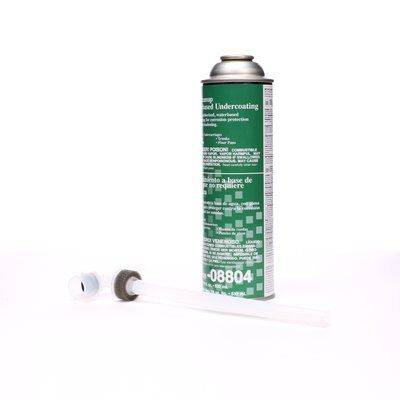

I use the 3m gravel guard. Its water based. It actually drys. And it you can load it on with little chance of running You need the gun and tubes. It is sandable ( you should use sealer) paintable and will not show pin holes are staining. Just a suggestion.

The 3M Schutz is what I used. Seemed pretty close to factory to me
I bought T-Rex bedliner kit that came with a shutz gun, it will do infinite size textures based off of the air pressure. You can even buy the tintable if you want, use a respirator though, fumes are pretty bad .
