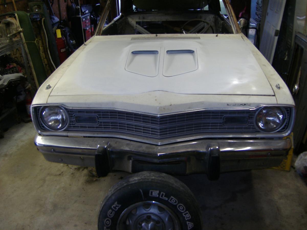

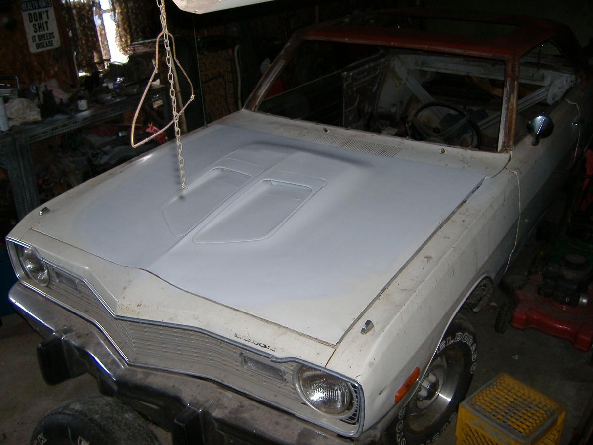

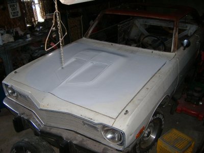

The hardest part would be that the Dart hood has acenter reinforcement the Road Runner doesn't have , but a good 'glass doctor could make it work . I used a 70 Coronet R/T scoop for my 73 Dart . It looks good and makes people wonder if it was built that way . DSCF0101_0243_243.jpg
The hardest part would be that the Dart hood has acenter reinforcement the Road Runner doesn't have , but a good 'glass doctor could make it work . I used a 70 Coronet R/T scoop for my 73 Dart . It looks good and makes people wonder if it was built that way .View attachment 28773
Looks good yea the brace is there but cutting only part of it gives u a place to attach the duct work to
