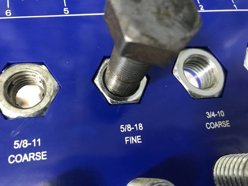

The following bolts came off my 69 Bee and not even sure if they’re correc.
The thick one (4 total) is for the lower arm and ball joint and is a 5/8-18 thread.
The skinnier one (4 total) is for the front caliper brackets and is a 1/2-20 thread. On one of them, the washer broke in half so keen to get replacements.
Are Mopar repros available somewhere, as I’ve yet to find them. May just settle on Fastenal ones.

After more thought and considering the safety around the bolts (brake and suspension components), I think I'm purchasing new bolts instead of trusting used bolts, especially after the washer snapped in half on the original bolt. The 5/8-18 bolt is a Grade 5 (three marks on bolt head), and can't tell what the 1/2-20 bolt is, but will get a Grade 8.
