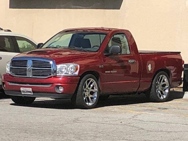

My 2007 Ram has 338,000 miles and will soon need another engine. I still like the truck very much so I intend to replace the engine and keep the truck going as long as I can. I do most of the work on my stuff so I'd be the one doing everything but the machine work.
I'd post this in the truck forum but the site traffic is so slow!
I have a few ways to go and have not decided on which one to do:
* Used, low mile engine from a wrecked truck.
* Rebuild my existing engine to stock specs.
* Rebuild any 5.7L engine using a 4.05 stroke crank and rotating assembly.
* Used 6.1.
I don't recall anyone here ever mentioning that they replaced the engine in their late model Truck or car. Anyone have any insight on this?

You have that many miles on the trans too?
I have that many miles on everything!
Original engine, trans, axle....Starter, water pump, alternator, SERPENTINE BELT!
I have replaced the EGR valve, thermostat, 2 transmission shift control modules, a rear axle pinion seal, several sets of spark plugs, brake rotors and lots of tires!
