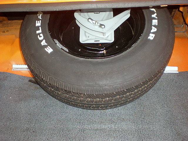

Note that the above pictured spare is mounted on a reverse offset wheel, not the standard offset. You may have to mount face side down to attach the jack parts to the mounting stud.

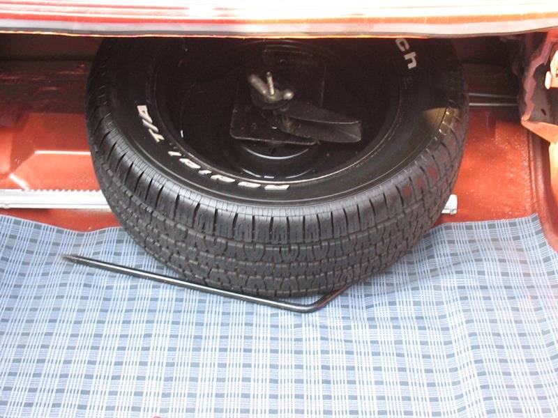

15x8 Ramcharger wheel,4 1/2" back space.

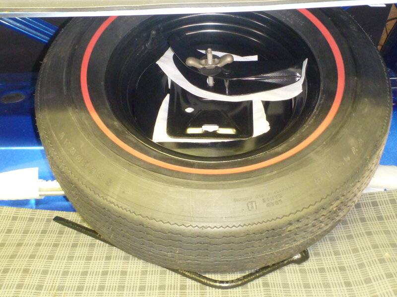

Mine has always been face side up like the redline tire shot. The jack instructions show the wheel being face up.

The tire looks to be either flat, too wide for this rim and the tires' bead doesn't look to be seated to the rim. For photo only ?
