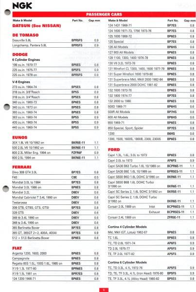

NGK '5' heat range. From my NGK catalog [ remember them? 440 cu in from 1960-74
BP5S plugs.
NGK numbers
