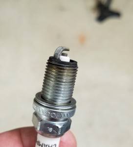

I running an edelbrock rpm performer intake manifold on a stroke 383 to 450 with aluminum heads with an 830 quick fuel carb. At first out of the box engine was running very rich so I changed the idle fuel restrictors a few sizes smaller and main jets from 78 to 71 .My idle AFR at idle is 14.5 My AFR at cruising ( 2,800 to 3,000 ) is 13.3 My issue now is that spark plugs 1,7,4,6 which are on the low runners are rich and plugs 3,5,2,8 on the high runnings are good

If the afr is ok, i would run a hotter plug. The plugs look like a pretty cold heat range.
What number plugs are those and what’s your compression ratio
Better pictures or clearer of the ground strap and porcelain
Timing
First off....those look short on the reach? How long are the threads? Maybe it's just the picture or the angle you're holding them at? Aluminum heads need a 3/4" reach plug.
That said, those both look pig rich from here....did you install new plugs after getting the idle AFR in the 14s? But, if the plugs are too short......
Dropping 7 jet sizes is a lot on an 830 carb with 450 cu in, but again I don't know that we can be getting an accurate read or making any suggestions if the proper reach plugs aren't installed.
If those ARE the correct plugs and I'm just seeing an optical illusion, IMO a good thorough tune-up is needed starting with the timing, transfer slots and float levels.
I'm also seeing oil on the base of those plugs. Could be from external weeps like valve covers, but if your plugs are the proper length, your AFR is mid 13s-14s cruise/idle and new plugs got that black that soon, next time you pull the carb off take a looky down the runners for evidence of oil in the chambers. A small telescoping mirror and flashlight can get you a peek at the valves. Excess getting sucked through the PCV line, rings not sealing well enough, or oil getting sucked underneath the valley pan (if you're using a factory-style pan) can get oil in there.

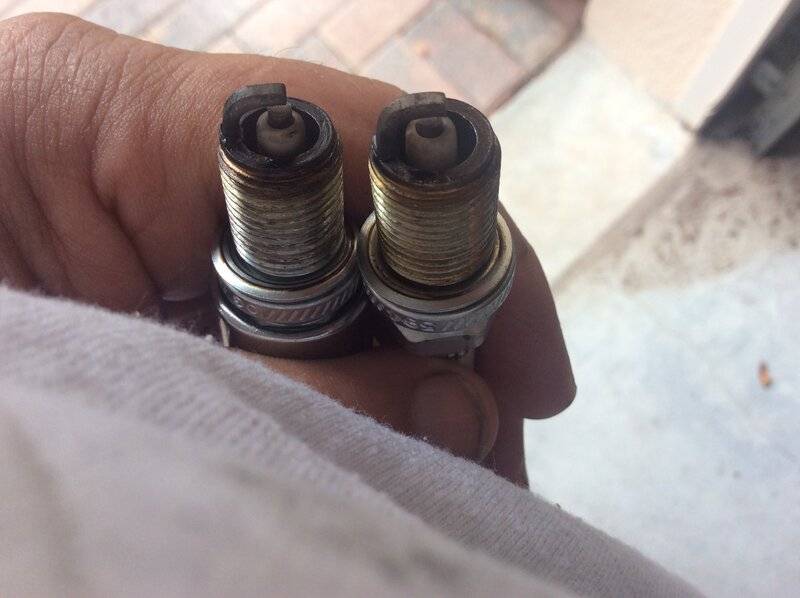

And you're putting new plugs in at least one or two holes before testing, right? Sorry if that's a dumb question....but once they're black, that's it..chuck 'em and put in clean ones. Get some miles on them before making a judgement.

Just to update. Took out the NGK plugs and went with as per suggestion to a two step hotter plug (RC 12Y) only put about 30 miles on them, pulled two plugs one from high runner one from low runner on my duel plane and they look much better than the NGK7 that I had in earlier
