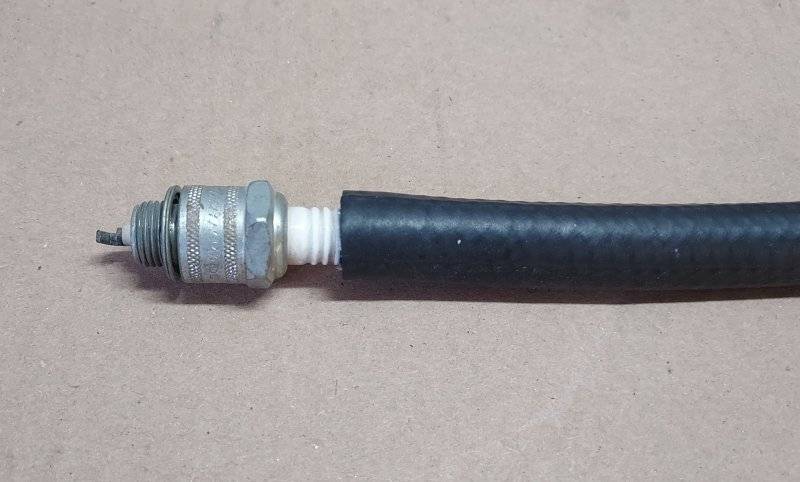

This is a good aid for the tight to get back in plugs. A piece of 1/2" hose helps to turn them in when fat fingers are too much.
BINGO< Great idea!
