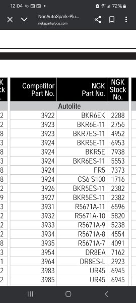

Good day, team,
Following up on previous communications, I've recently acquired a 1967 Coronet equipped with a modified 440 engine, reportedly generating approximately 542 horsepower.
The vehicle features aluminum Edelbrock cylinder heads and an MSD ignition system. During a routine spark plug inspection, I observed Autolite 3924 plugs installed. I'm seeking direct cross-references for NGK and Champion spark plugs to ensure optimal performance. Online resources have provided conflicting information, and I would appreciate expert guidance on this matter.
Your assistance is, as always, highly valued.
Thank you.
Why not stick with the Autolite? Autolites seem to run and last in my Mopars. Champion never seem to last for me, and NGK has been a choice of many here, but I haven't personally tried them.
I would go with an R5671A-6 .. or -7
