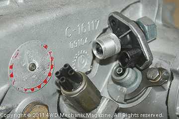

Just thought i would pass this along for anyone running a torqueflite /A 833 transmission, or even a 42/46 rh/re behind a 3g hemi. Im putting an 18spline behind a 3g and need to generate a speed signal. Im going to use the sensor off an early 90's jeep wrangler. Looks like this
It screws onto the existing speedo gear housing and the cable attaches to it. That way the factory guage still works. I just ordered it. Hope it works. Anyone else tried it? If not, once in and running i will report back
I'm curious.....please report what you find.
I just found one on ebay for 10 bucks!
No, it's new. But it does not have an end for the speedo cable. Should work for a programmable speedo.
