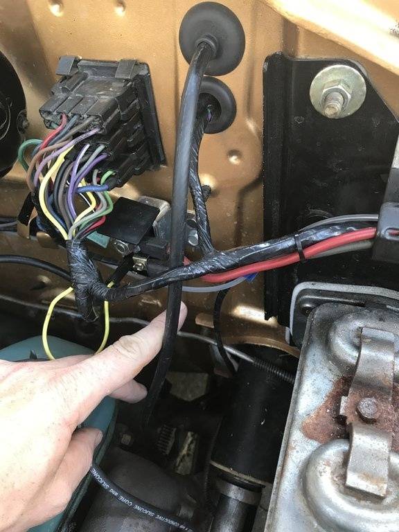

Hey guys, where does this speedo bracket fix into? Anyone got a photo of one in places as my head is wrecked.

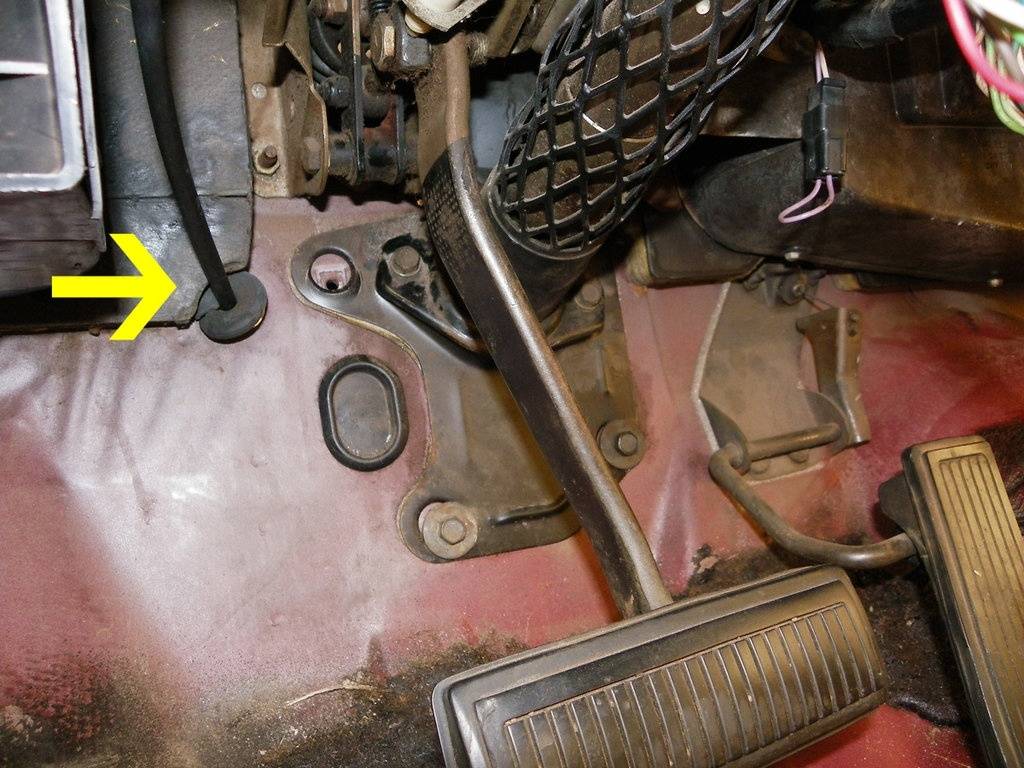

To the far left in the picture..Driver side inner fender

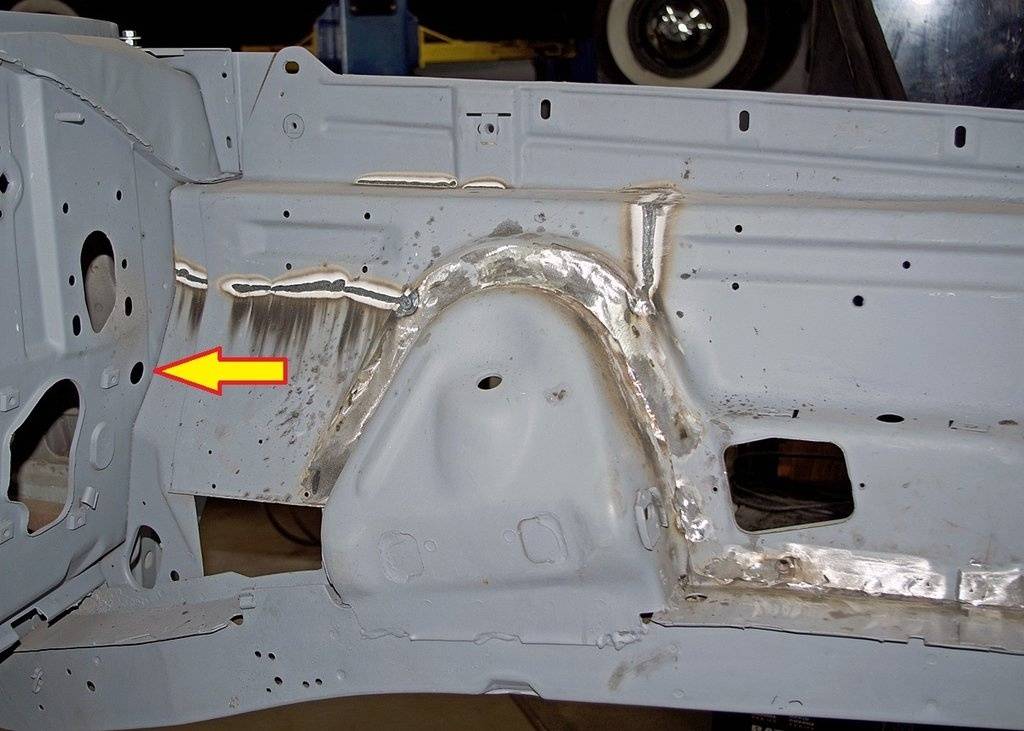

The problem is it is in the wrong hole that is why it seems shorter....There is a hole below the Master cylinder and inner fender area just north of the frame rail....

in my build thread in the restoration section here on the last or second to last pages....
Oh wow thats really low, I would never have thought of looking there
It may look low, but you will find that it's right in line with the back of the speedo. Remember, the gage set is not level, it all tips back a bit to line up with the drivers field of vision.
