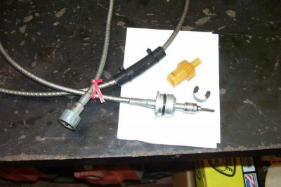

looks like the OP has a 65 plymouth. 65 and earlier have different speedo pinions and cables.
100_0309.jpg65 should look like this.
