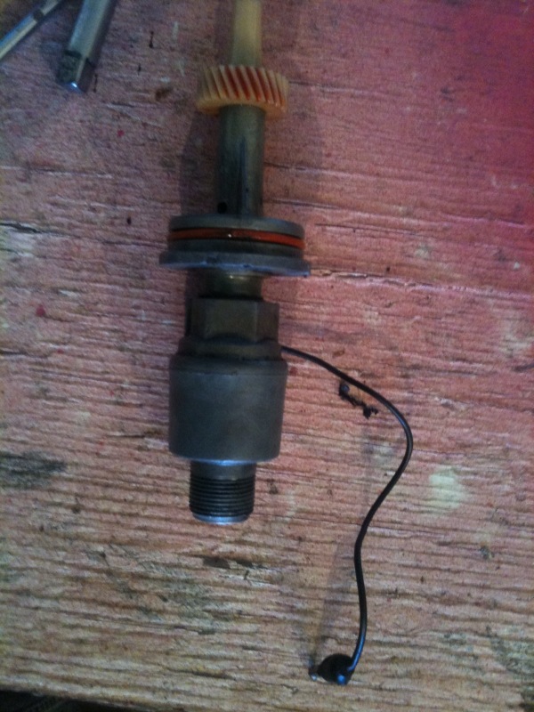

Is this for the factory cruise control ?
Thanks
anyone have factory cruise on their 1971 RR , SS, or GTX. that can verify this part ?

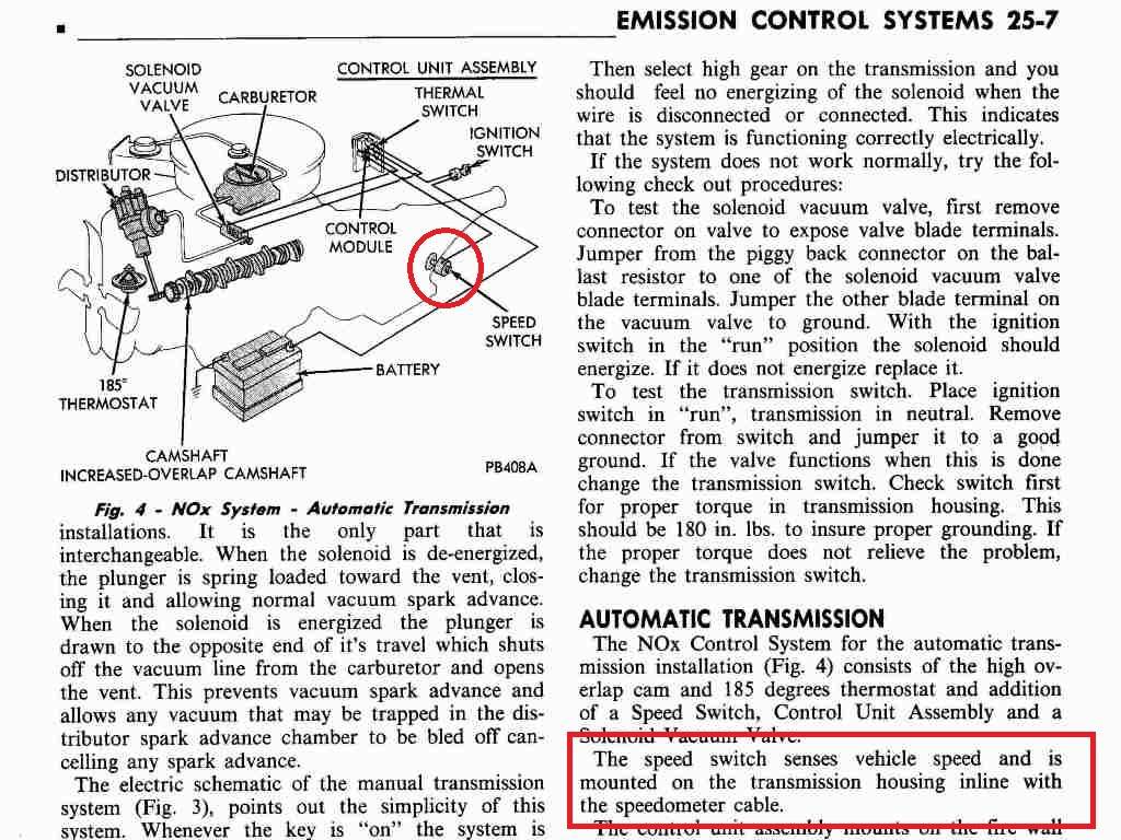

California car? It's a NOX system speed switch. I thought 72' was the first year for that system however. Trans numbers matching to the 71'? It can be removed, cable fitted directly to the retainer.
Hahaa thanks ..
Ya it is a 71 cali car,, starting the 440 4-speed swap so we aint going to need that no more.. Lol
i guess it can go in the box with colectables then :)
i would have never guessed.... Thanks 72roaddrunnergtx
