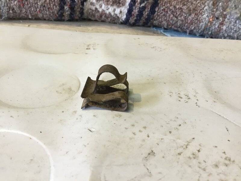

Where does this clip fit? Supposedly on the frame rail. It is for the speedometer cable.

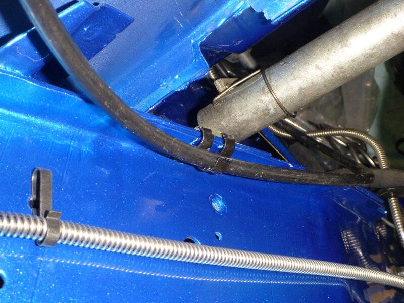

It goes on the driver side frame rail lip right behind where the rear brake hold off valve would be. Kinda under the floor pan
