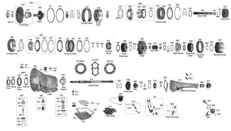

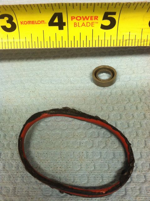

The beautious 727 breakdown on the top is from transpartsonline.com, who sells all of these parts separately. The photo on the bottom is an actual picture of parts 368 (large red O ring on which some prior mechanic apparently put black silicone) and 078, the gray speedometer drive lip seal. It is this lip seal which supports the speedometer drive shaft. Not shown here is the small steel split ring which presses into the speedometer drive housing to hold the lip seal in place.
If your speedometer cable is leaking, remove the 1/2inch bolt and retainer holding the speedometer cable drive in place, note the position of the drive (number printed at varying positions on housing - the one at the 6 o'clock position being the relevant one), remove the drive and replace these seals. Replace. 15 minute job requiring a half inch wrench and $3.00 worth of parts.
BTW: I jacked up the car to a level position. Luckily I was prepared with a catch-can because I lost about 2+ quarts of trans fluid out of the speedo drive hole when I pulled it out. Can't say I wasn't warned - see the prior post from Mike Z! Apparently the speedo drive is under the fluid level when the car is in a level position - makes sense, the drive housing has lube holes on the inside where the trans fluid lubes the turning shaft.
