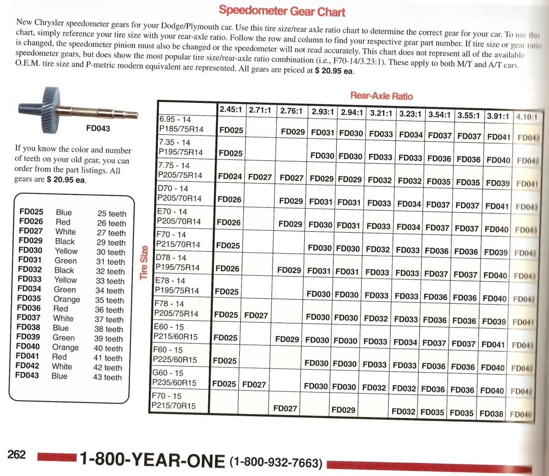

Hey tpod...looks like you'll need a red gear (36 teeth). Year one will fix ya up...attached is the chart they post in their catalog in case you don't have one.

The chart I have shows tire diameter and the gear, no tire sizes and I show the 3.55 gear and a 27 in. tall tire to take a 34 tooth gear.

Gents...please note that the list that I posted was from an old year zero catalouge...was just for gearing info..not for price...apparently their plastic has gone up in price!!! Sorry for any confusion, should have blacked out the price before posting..my bad.
